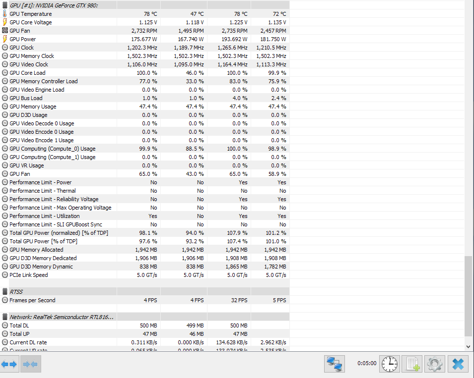

Got a pic of the gpu software while doing the work?
Only really pay attention to max, this was running for over 9 hours.
the 80c was 100% fan speed, and when it got there, I was playing with msi afterburner and set a max temp of 70c as the priority.
The voltage seems a little high. The clock speed was always in the 950-980mhz area.

Well need an idea of real time specs. Max won’t help if we can’t see how it got there.
I'm now really confused, it was hitting 92c last night, but now the max is 79-80c unless I raise the power limit...

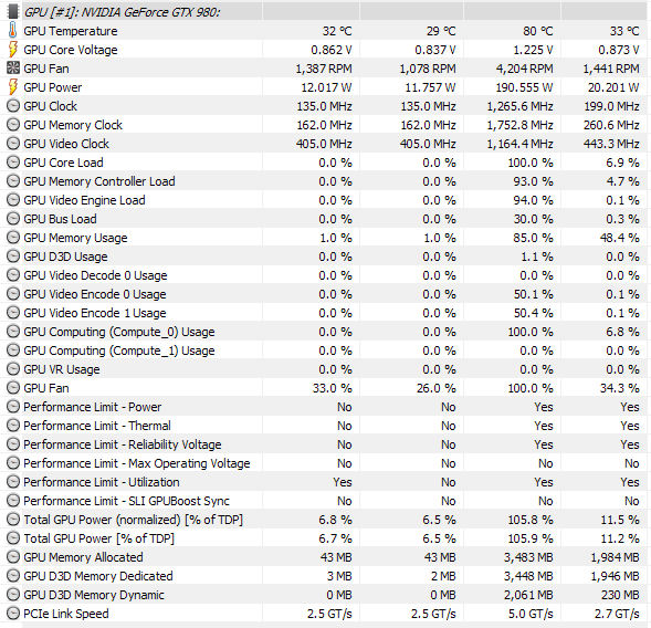

More aggressive fan curve is keeping it at 80c after 6 minutes this is a picture after 5. (The benchmark started 5 minutes 10 seconds ago, so 47c is not the idle)
