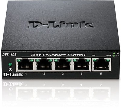

2.) Switch would be a like below. One in to many, say if you had a pc, xbox etc.
D-Link DES-105 5 Port Fast Ethernet Switch
