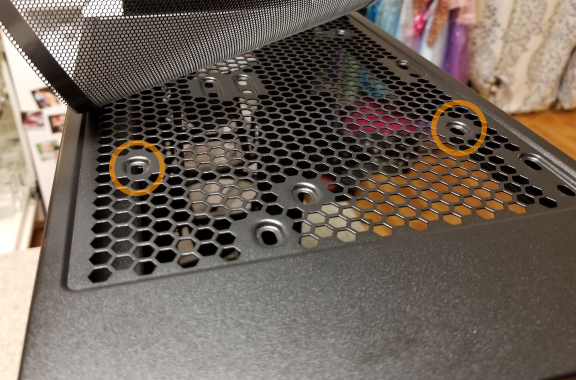

I haven't bought anything yet, but was thinking on using the H500 with a 200mm at the top so I don't have to buy a splitter (because I would run out of connectors)
@seoz Why can't I put a 200mm as a top exhaust on the CoolerMaster H500? the website says top 200mm is supported :(
What website? There is no physical way a Cooler Master H500 supports a 200mm up top, I guarantee you it's only the fronts.
There are holes at the top for a 200mm fan.
Did you mean moving the front 200mm to the top or adding another one? You could just leave the top mounts empty instead.
