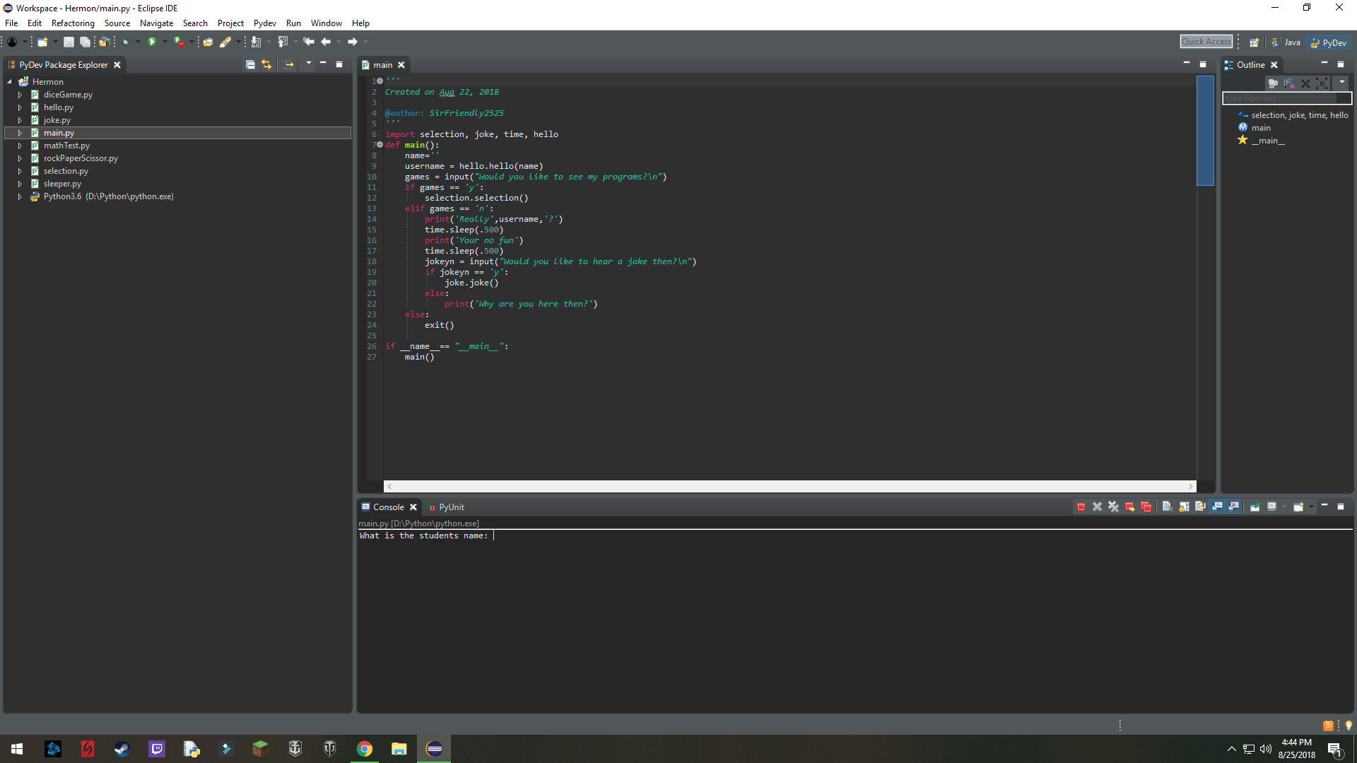

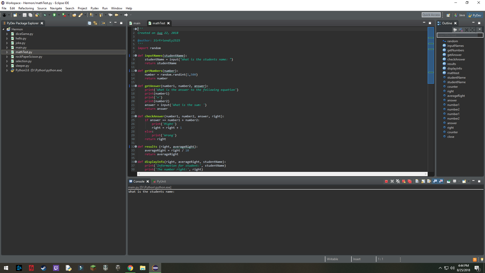

Thank you for the reply. I have a basic understanding of python (super basic) but this might help, Here is the main module for this code. I will attach a picture of the mathTest module that keeps running first.
At the bottom you can see the console output shows the first input line from the mathTest module and not the main like it is suppose to.
Yes, I have selected the main module before running to tell the program i want that code to run but no matter which one i select it always runs the mathTest module.
(There are a few logic errors in the mathTest code as well but that shouldn't effect it running only the expected output for that module)

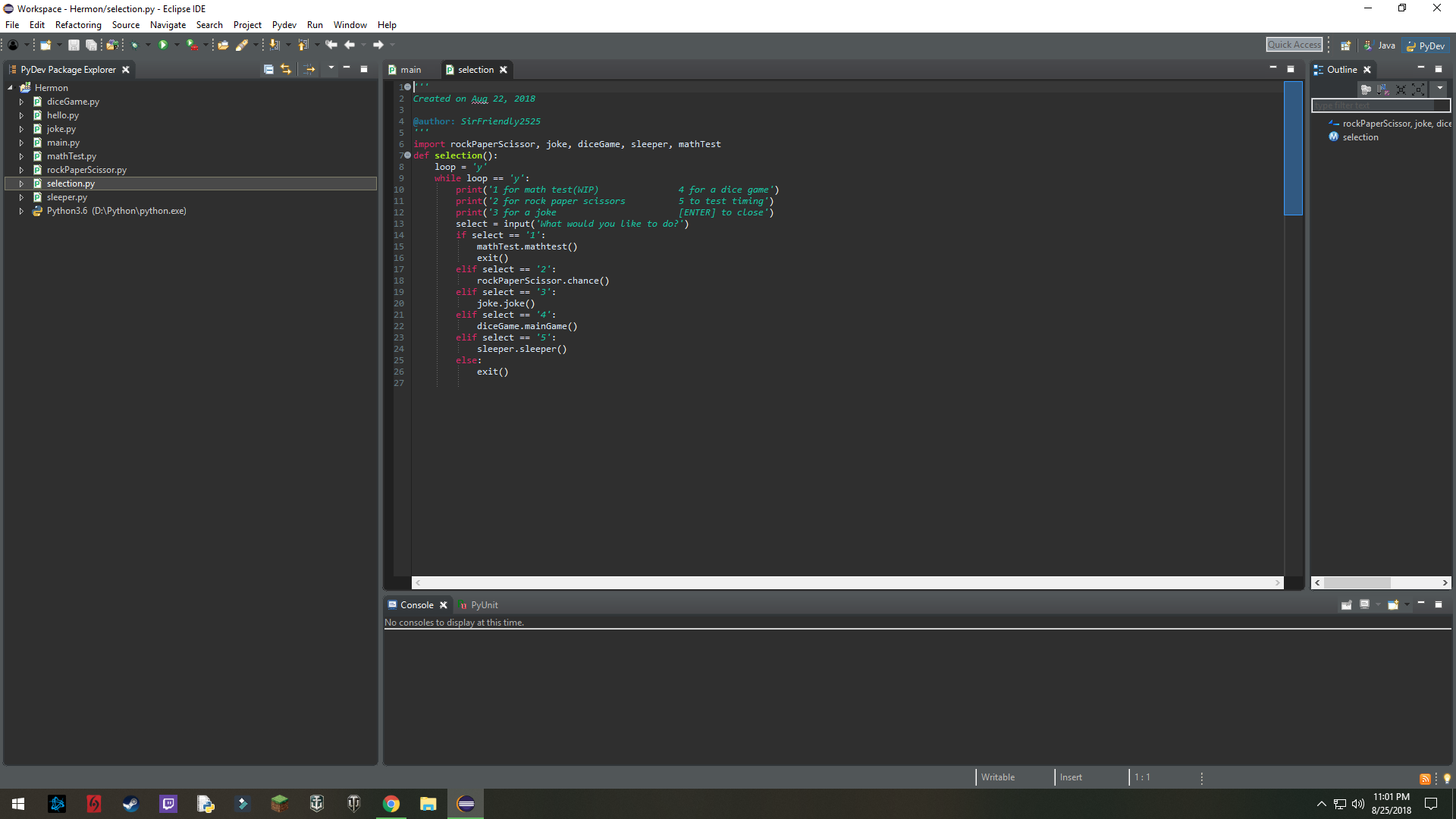

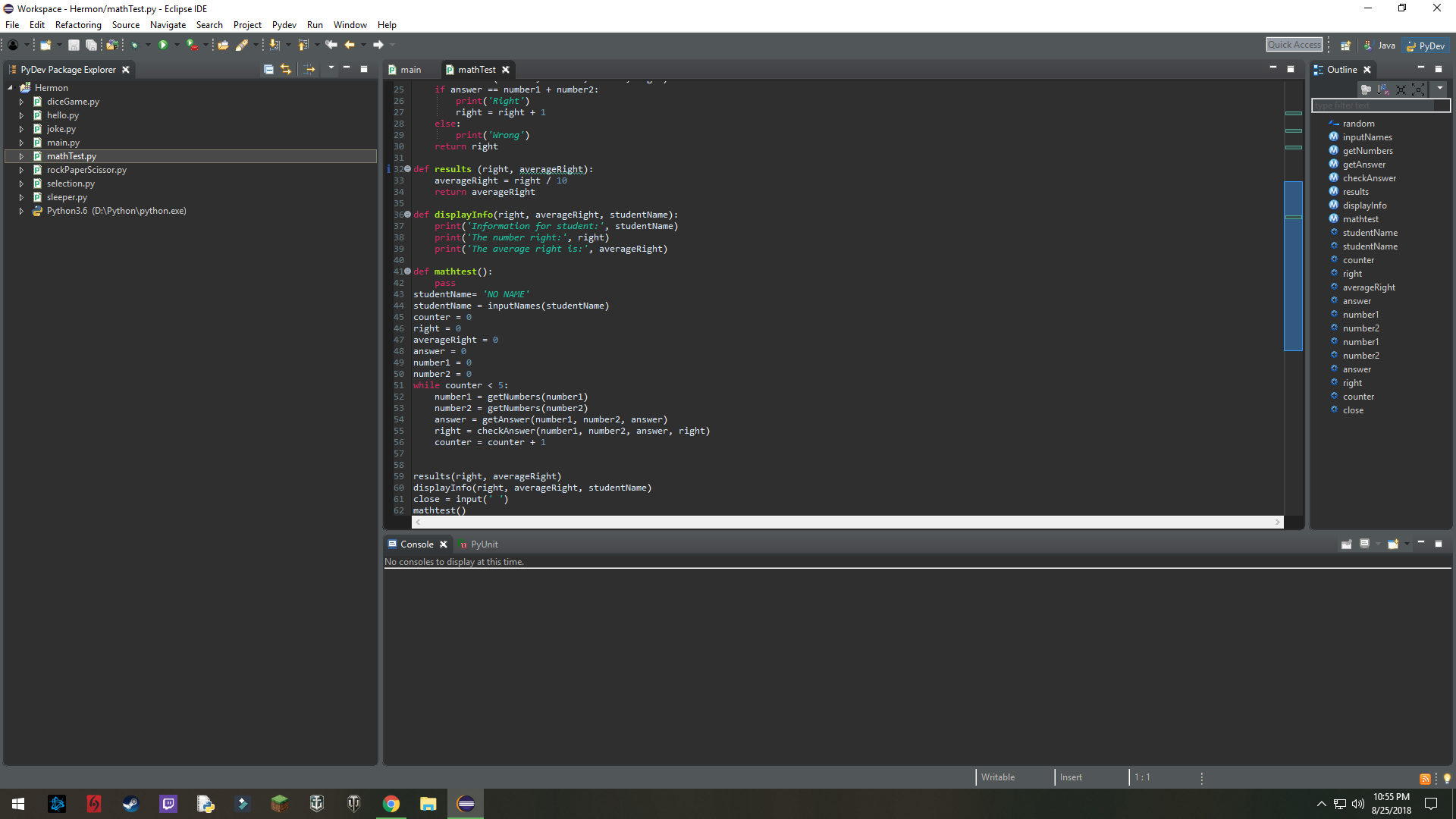

My apologizes. Here is the remainder of the mathTest code.
I know the code for the mathtest does not give me the correct output but it does run without to many problems.

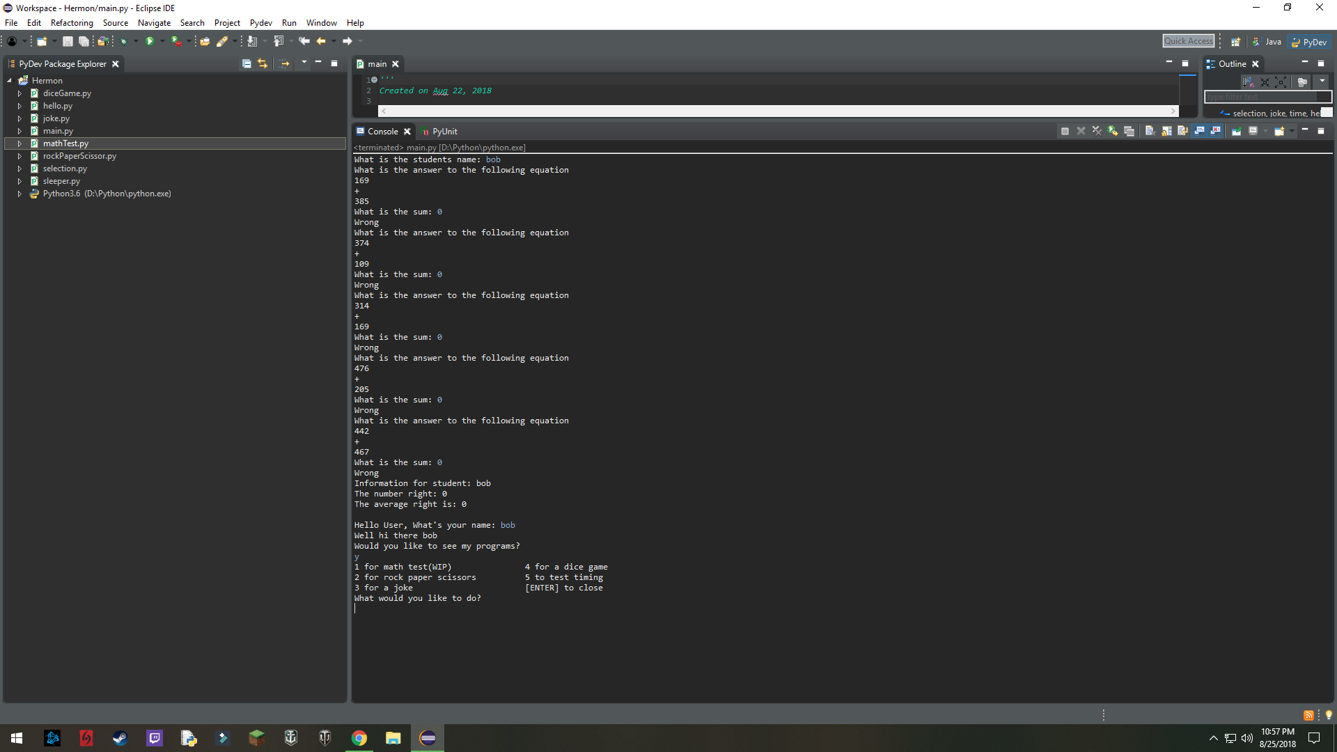

My issue is that it overrides my main module by running the mathtest first then it runs the main.
I have attached image of the console output as well. For some reason, the mathTest runs first.
when i go into selection module and make the call to the mathtest a note, the program runs just fine. once i enable the mathtest in selection it creates this issue.
I have attached a third image of the selection module as well, if it helps.

The problem starts on line 43 of the mathtest module. If you intended the code to run inside the mathtest function, you need to indent the code. Otherwise it's out of the function's scope and mathtest is a function that does nothing. And since the scope outside of the function definition is basically the global scope and what I said earlier, Python will execute that code the moment you import the module.
