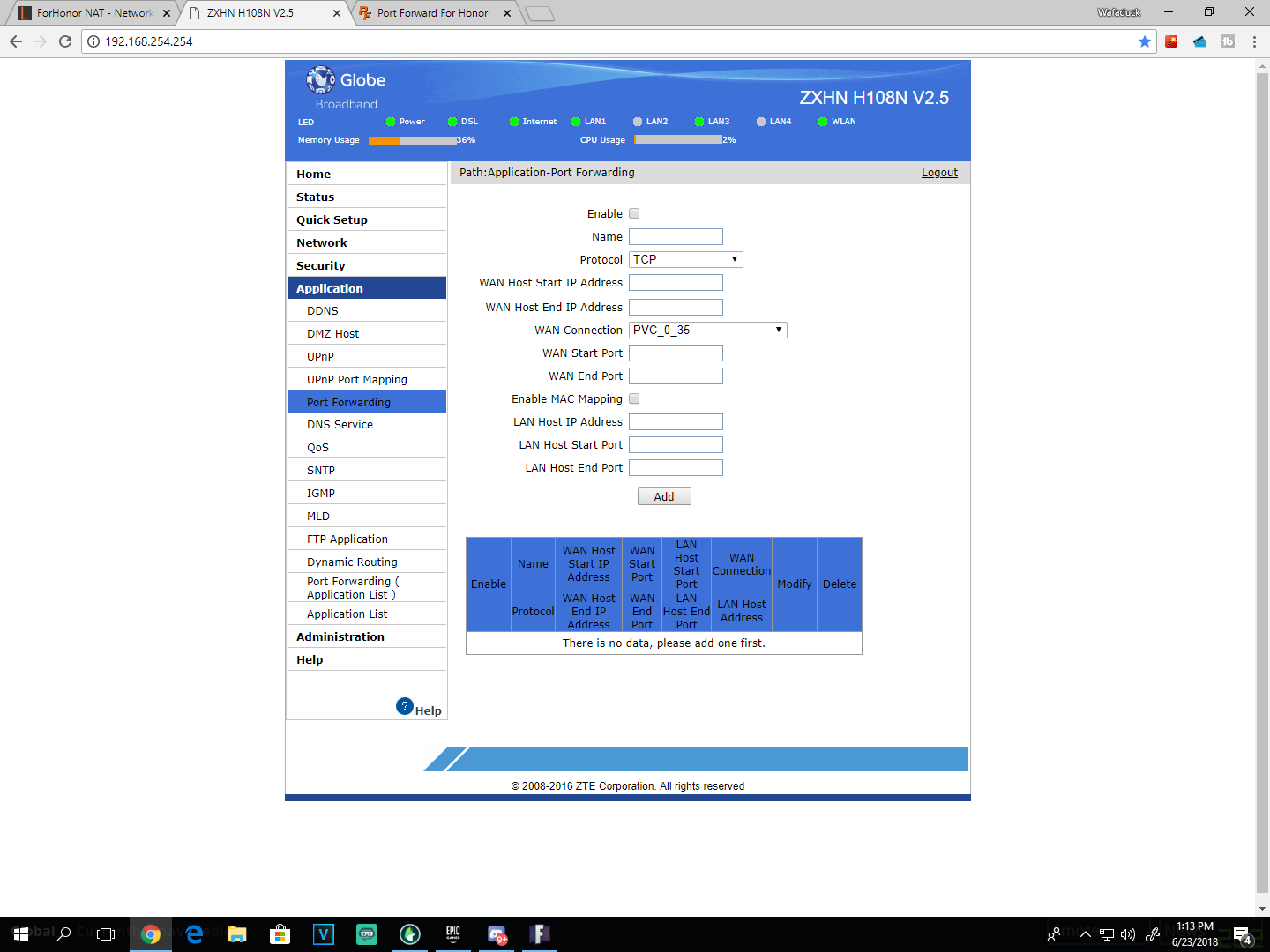

oh cool. can you show me which part exactly where in my router?
5b2dd6f0a07f5_DesktopScreenshot2018_06.23-13_13_29_28.thumb.png.d727313381e8900c2a9f6d45dbf9d5a0.pngIs this the correct area for portforwarding
https://linustechtips.com/topic/940439-forhonor-nat/#findComment-11468096
That is the area. Every router displays the configuration differently. The only standard is what values you input.

On 6/22/2018 at 11:29 PM, Wafaduck said:
My ForHonor says nat is STRICT? that means I can't play online which sucks. only against bots. do you guys know any clue on how to fix this? They said portforwarding the ports do. anyone can help me on that?
Enable UPnP. Look at your screen shot you posted, its two tabs above port forwarding.
Port forwarding is a very bad habit and a last resort. Do not do that.
