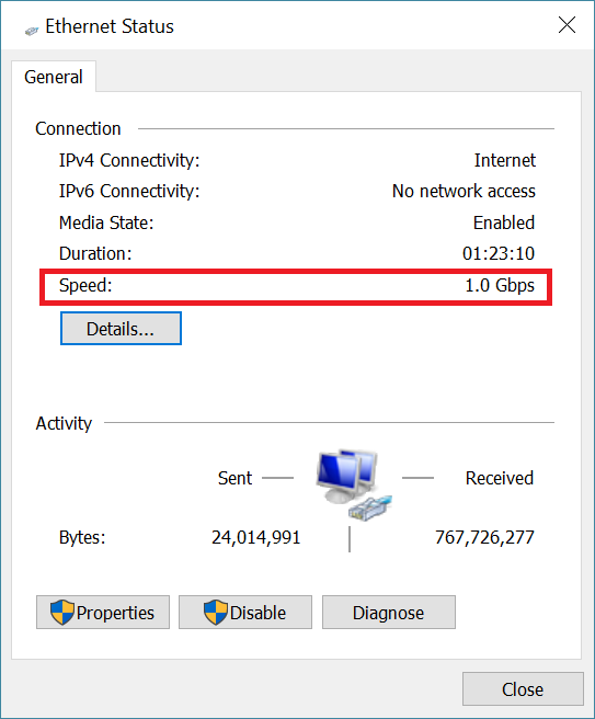

Well tinkering with ever single setting on this guy I am starting to think its probably only using 100Mbps ethernet ports. Didn't want to upgrade as the routers I have been looking at are in the 160 - 200 USD range.

You can verify that by looking at connection status in Windows when connected to it. Realistically, if it only had 100mbit ports, it would be impossible to get beyond 100mbit speeds.
OMG YOU HELPED ME SOLVE IT!!! when I saw it was limited to 1Gbps I knew something was up I dug in the settings to the router changed a ton of stuff saved ran a test repeat. It was the media prioritization I had it on thinking that if someone in the house watched Netflix on the tv and I was downloading a game it would prioritize my pc over Netflix as my pc was saved in it once I turned it off boom I am now getting 495Mbps I assume loosing some speeds dude to routing to my router then the pc so case closed thank you very much!!!

Glad to hear that mate, Quality of Service (QoS/traffic prioritisation) is usually awful on most home routers, so that's what I was getting at when I mentioned router settings in my earlier post :)
Hope that's the last of your network woes!
