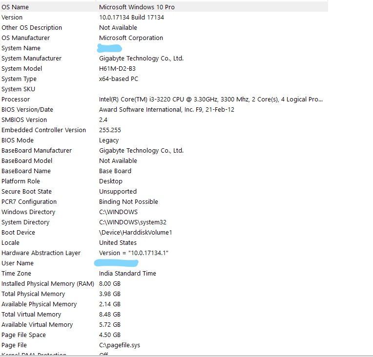

4 minutes ago, D3V_Sh said:

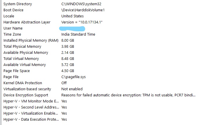

here it is ram tab task manager
One of the sticks is being marked as hardware reserved. This could be a fault RAM slot or module.
I'd advise removing one of the sticks and booting the system. If it works, move that stick to the other slot and boot again. Then switch in the other stick and try it in both slots. If both fail to boot in one of the slots, you've likely got a faulty RAM slot. If one stick fails to boot in both slots, you've likely got a faulty RAM module.
If both work in both slots, you could try updating the BIOS.

How usable number changes when only one RAM stick is installed ?

Can you give us the full config ? MoBo, GPU, CPU, ...

We may need to know your Motherboard model, CPU model, RAM model and so on

Check pins in CPU socket, increase IMC voltage.
What exact RAM are you using ?
Can you screenshot "SPD" tab from CPU-z ?

What BIOS version are you using ?
(CPU-z "Mainboard" tab - it's "Fx" value, where "x" is a number from 1 to 10)

Newest BIOS is F10 : LINK.
It improves compatibility with your CPU.
It's worth updating to checking if it changes anything.
Also, check in "msconfig" (run command), if you have a check box "maximum memory" active (it's in advanced settings, under "Boot" tab). It has to be greyed-iout.
If it's not, uncheck, save changes, and restart your PC.
