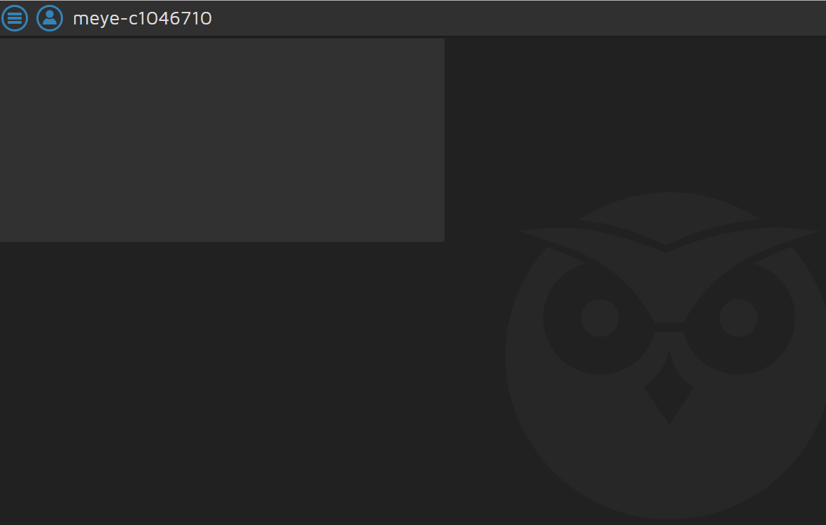

I need some help.
I flashed montioneyeos-rasberrypi-20199119 onto my pi zero w and the only configurable setting I see are Fit Frames Vertically, Frame Rate Dimmer, and Resolution Dimmer. I can't adjust anything else or set a frame rate.
FIX: on the login screen, login username should be admin and no password as default
