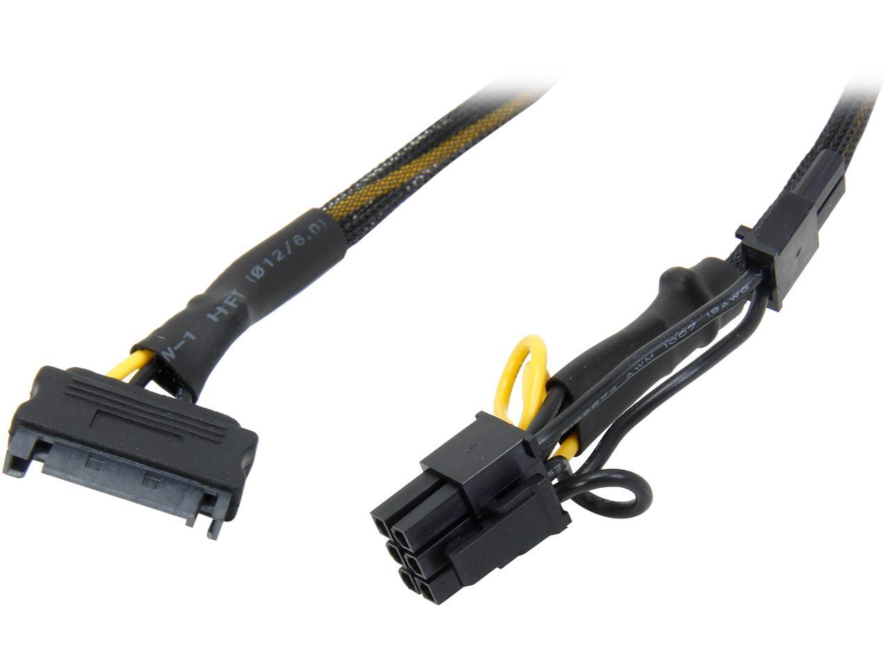

Here are my thoughts, after reading some stuff online i found out the GPU requires 38A on the +12v rail also uses 2x6 pin connectors and the PSU only had one so i used THIS to get the other 6 pin.
1) Did I use the wrong PSU?
2) Should I not have used the adapter?

I may be wrong but I am pretty sure Molex to 6pin is better for powering a GPU where as SATA power to 6 pin probably isn't good enough but I am not too sure this is more of a guess

The only thing that stands out is the SATA to PCIe adaptor. SATA really isn't designed to output that much power.

Likely fried because of the crummy adapter. By the way, if a 650W PSU doesn't even have two PCIe cables/connectors, it's usually a sign it's not up to the job.

3) STUPID me, i had a molex to 6 pin also... crap... anyone else this this is the cause?

In that case, why the flying fornication was the adapter used at all, one might think :)

i know, it's a PSU i had sitting around and a stack of modular cables for it, and couldn't find another 6 pin cable so i used used adapter (stupid me)

So we all agree? it was the SATA to 6-PIN adapter that caused the issue most likely?

Why do you assume it is the PSU that is fried? Have you confirmed it was the PSU that died initially and not a motherboard issue shorting things out? You are having motherboard issues now it looks like, which is why I ask. I have seen similar issues where people plug a motherboard 4 pin into a pci-e or a pci-e into the 4 pin (not saying that is the case here). I just don't see a Sata to pci-e adapter killing a psu. If anything it would have just under-powered your card creating stability issues, but unless the connector was shorted... then you should have no had an issue.
