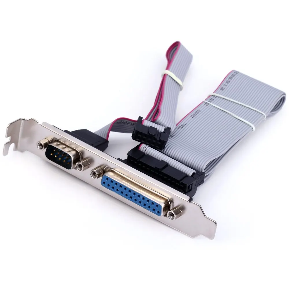

In the old days they are mostly used for serial and parallel ports, where you can just secure them there instead of wasting a precious I/O slot, since those ports are just connect to the board with a ribbon cable.
Serial-DB9-Pin-COM-with-Parallel-DB25-Pi
My point was to not use up any pcie slot as well, so unless I intend to invite the angle grinder man over I don't think I'll buy something like this
