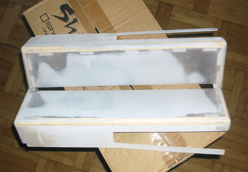

New plexiglass roof on!
Took me 10 minutes to sand the roof and prime it with perfect result :)
But i found one more fault, it was too wide. Cut away one inch from it.
When i was done, i remembered that all other parts now is to wide too...
Two part WOPR
Now this is the last changes, i dont have time for more errors :)
