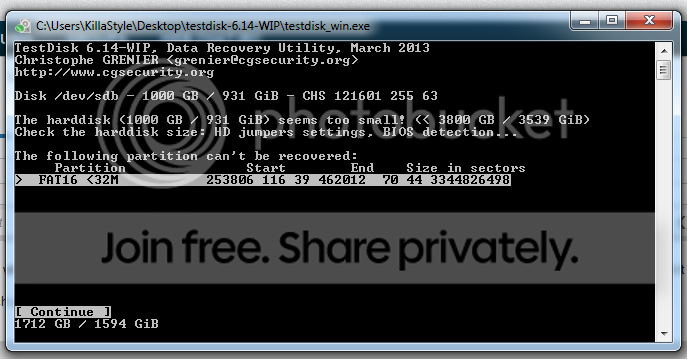

Done some research and I tried "TestDisk" and analyzed the HD. After many hours of waiting and praying I get this:

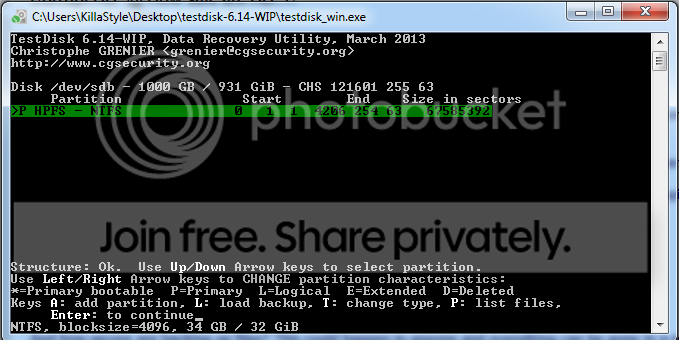

and then when continuing
What do I do now? All hope lost?

Anywho, sounds like your partition table is corrupt. Did your machine bsod before this started? Leaving the drive plugged in shouldn't be a problem. I've had a Seagate 1 Tb external for probably close to six years now and it still works although I think it's just starting to show signs of failure (aka click of death). Have you run a virus scan? I've seen malware do some funky things to drives on infected machines. Boot into safe mode and run whatever you've got.

DO CHKDSK FIRST if it doesnt work then do the below
Download Minitool Partition Wizard (home edition will do)
-Remove the partition using minitool partition wizard
-Click partition recovery wizard
-Select the disk where partition was located in
-Select the space where partition was in
-make a quick scan if quick scan doesn't work make a full scan
-if your hdd shoved up click finish
