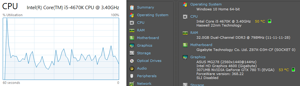

I am not that experienced with PCs compared to many of you so looking for some advice. My i5-4670K at stock speeds is running at 50-55 degrees idle. I have the Coolermaster 212 air cooler which has served me well. It used to run at 28 idle, now it's close to double that. Can anyone offer some advice as to why this may be the case and what I can do.
Specs:
HAF X
i5-4670K 3.4GHz
GTX 780 Ti: Evga SC w/ ACX
32GB RAM
Gigabyte Z87X-D3H
My GPU is also running at the same sort of temps idle, when looking at reviews it should be about 20 degrees less. Incidentally my hard drives are both running 50 degrees which I don't think is right...
Any advice? cheers

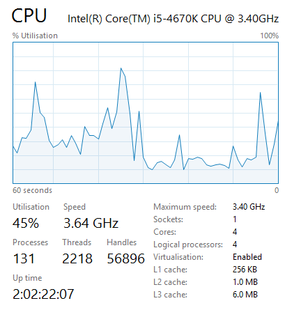

btw, this is a graph of my CPU usage. it seems a bit strange given that all I am actively using is Chrome, with some basic apps in background like Bullguard and Steam.
