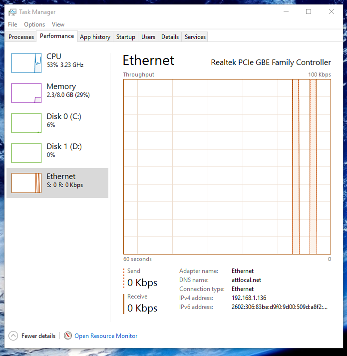

I assume it's running Windows 8, 8.1, or 10. Open task manager and go to the network meter and see if it's actually using bandwidth or if it's some weird communication between the AP and the desktop. If you're still running 7 you'll probably have to download a network meter as the built in ones don't work the way you'd expect.
Looked at it, the send is no higher than 1.2mbps and the receive is less than 50 kbps. No programs can connect  (spotify, skype etc.) And chrome gives DNS probe errors, even though just before I restarted it is downloaded a 3GB CAD program effortlessly. Had to turn the PC back off to submit this reply because I was getting DNS probe errors on my phone as well (have to use it because if the pcs on nothing in the house gets internet)
