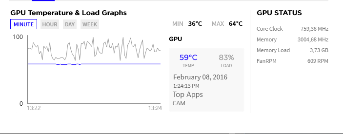

So as my title says Im thinking about replacing my MSI GTX970. This due to it becoming unstable lately. What Ive experienced is that it sometime (Specially in games that change and load new maps often) gets framedrops down to >15fps until I restart my game and I thought that the Ram thing with the card would not have that much of an impact, but it sure looks like it. Im having NZXTs CAM up on my second screen while playing to see what goes on.
When the game (Lets say Black Ops 3) runs SMOOTH the card loads 3,9Gb VRAM and Core load lies around 40-50% and no framedrops or anything, I get a smooth 60FPS (Capped it there, uncapped I hit 100+). I can then play for a couple of hours until I take a break and close down the game.
Later on the day I can start the SAME GAME back up and play a couple of rounds on the SAME SETTINGS and see that my GPU loads 3,6GB VRAM and has a coreload of 99% and I get those >15FPS drops ever other seconds or so.

Well I don't know wether its that or not, but my issue has not been a continously low frequency of my GPU. It has started working well as it should, then seemingly lowered itself independant of anything (As far as I can see at least) where the only thing I have noticed is that when it DOES have my issue it also does not allow the game to use more than 3,6Gb of VRAM. While it does work flawlessly with 3,9Gb VRAM used, it does SOMETIMES struggle.

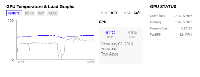

For reference, this is how it looks when its working as it should. No framedrops, no stutters.
I do notice the Coreclock is "capped" at about half of what it normally should be able to reach. Memory clock did hit 3500 when it stuttered as well, but I didnt manage to capture it
