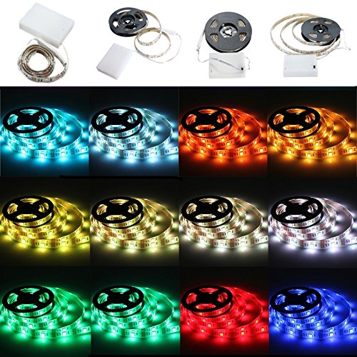

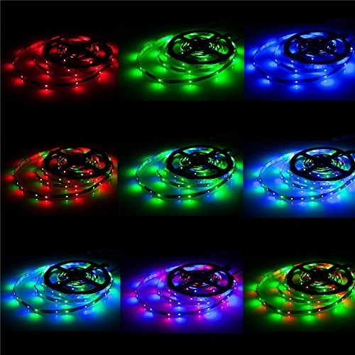

The SMD5050 LED's has the three RGB colored lights(diodes) together in one chip where the SMD3258 has each RGB colored light individually. This causes the strip to be more of a rainbow than able to smoothly cycle through a bunch of different colors like the SMD5050 LED's:
SMD3258 Rainbow Effect:
http://ecx.images-amazon.com/images/I/510XU0%2Bx8pL.jpg
SMD5050 color shift:
http://ecx.images-amazon.com/images/I/61HWfvHQ6YL.jpg
led-5050-vs-3528.jpg?t=1402007798
