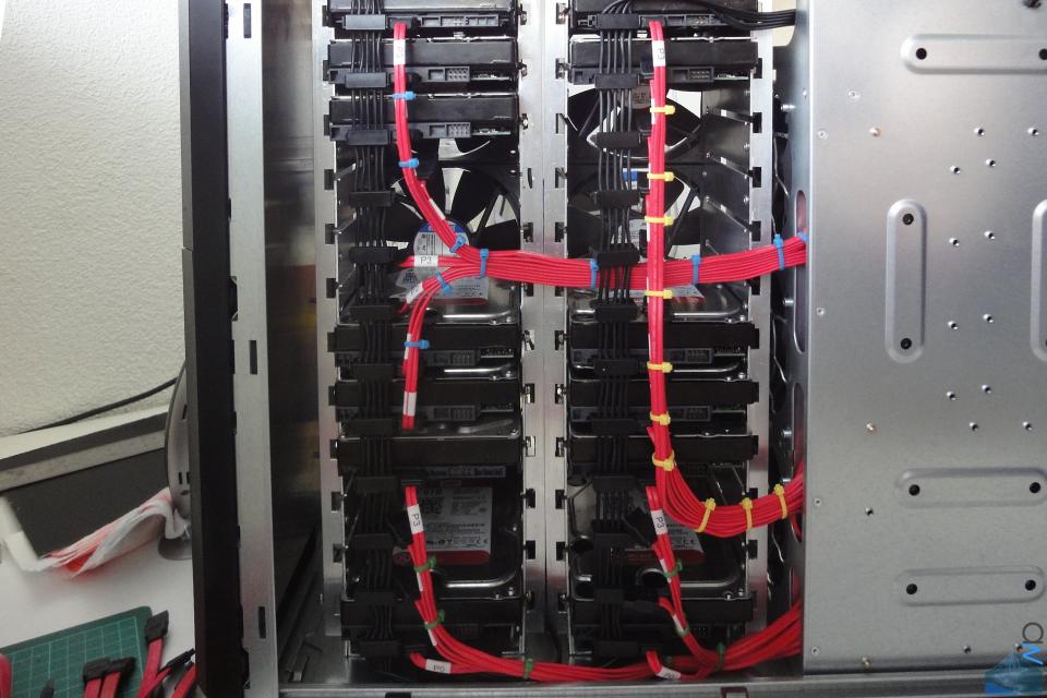

I have run up to twelve drives on one cable without issues. Should be fine.
(It's not twelve on a single cable in this image since I've changed the config, but you get the idea.)
aw--apollo--2014-04-13--21--disk-rack-ca

Yeah, your PSU needs to be able to handle the spin-up current for the drives, since it
can spike pretty high (not an issue if your machine does staggered spin-ups though).
Six drives should be fine though as long as you have a halfway decent PSU. My server
(the pic above) uses a 550W PSU, haven't had any issues so far. If you have a multi-rail
PSU, it might be a good idea to have a look at which rails support how much current,
since sometimes SATA rails aren't too powerful.
