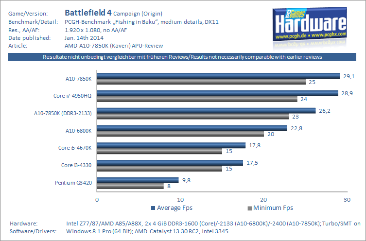

It's true that you won't outrun a consol with this build, but this wasn't the purpose. I tried to make a build, which costs about the same as an console and has about the same performance, but has, as you said, the benefits of a pc. The rule i set for this build was, that it plays nearly any game with mid settings at 1080p at 30fps. In BF4 you get a min of 25 (source:http://www.pcgameshardware.de/screenshots/original/2014/01/Kaveri_APU-Benchmarks_BF4-SP_1080p-pcgh.png) and if you overclock it, you have the 30 fps.
I called it a console killer, because it has the benefits of a consol: A OS for couchgaming and it is cheap and it has the benefits of a pc: games are cheap, it's highly customizable etc.
