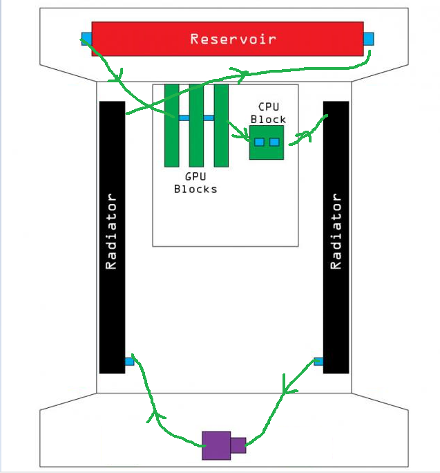

Okay so I've had this idea in my head for a while of how I'm going to build this case from scratch. To start making 3D renders I need to figure out the hardware I'm going to use and where its gonna go. I made this sketch because I want to get people's opinion on how I should do the loop. The easiest way to do it is to have the CPU and GPU's on a separate loop to each other but I would prefer to have them all in the one loop. If you guys can give me a few ideas of how I could run the loop all in one. (e.g Res > pump > Rad > CPU > res etc...)
Cheers!

Separate loops are possible, but if you're not going to do that, then you should run the GPU's in parallel, and make sure there's a radiotor in the loop between the CPU and the three GPUs.
I would put the reservoir in the bottom of the case instead, or in the top. Maybe even both?
When in doubt: C4
@Scrivyyy Show tubes in pic! Looks cool so far
Cheers! yeah the idea is you guys are helping me with that :P I'm not entirely sure where to run them yet.
I watched JayzTwoCents build logs and update for skunkworks. He said there is less than 3 degrees of difference from when he had separate loops to running the liquid through all in one go.
I just don't see how I can run everything through together without having to run 1 tube across the whole case
@Scrivyyy Hmm, you could have 1 huge loop like this?
But... the Res is above everything (you could put it on the bottom) and there are cross overs going across the case  :(
