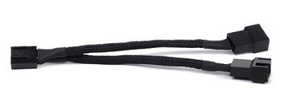

is the fan splitter look like this? Then I should search for the one with 1to5 splitter?

1. You could get a PWN splitter like this one
http://www.newegg.com/Product/Product.aspx?Item=N82E16812162026
or you could get a "splitter box" which comes with some cases/motherboards.
http://www.swiftech.com/8-WayPWMsplitter.aspx

Can I use splitter in the CPU_FAN ? and plug 1 cpu heatsink fan to the splitter, is it ok?
because I think I'm gonna be using the SYS_FAN and the CPU_FAN.
You could in theory. Not sure if you can control them separately. I would just split from a normal fan header and just leave the CPU fan header be.
