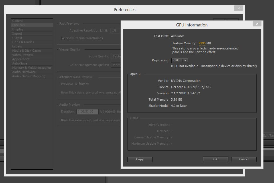

Can somebody help me the option is greyed out for some reason

I tried that but I get an error after that so I reverted
Help please

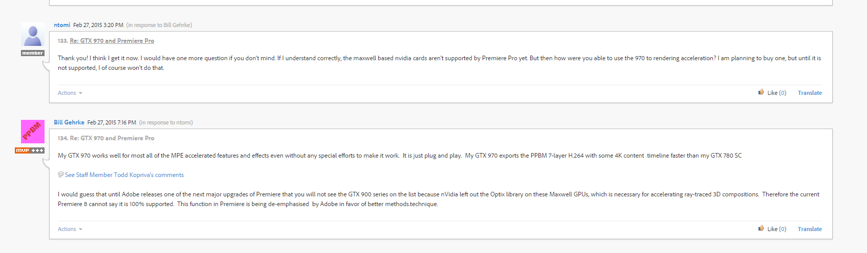

https://linustechtips.com/topic/325678-adobe-ae-not-using-opengl/
Found out Maxwell cards aren't supported......
