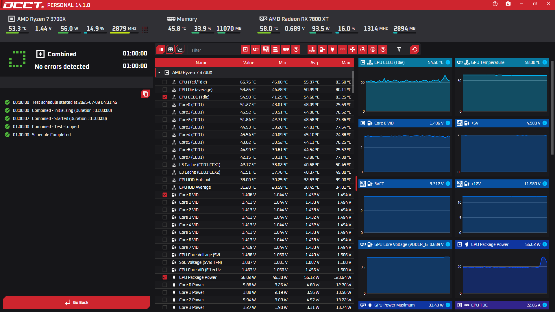

3 hours ago, FrostyPawz_ said:
I ran Combined with all the options on
Seems ok I suppose.
