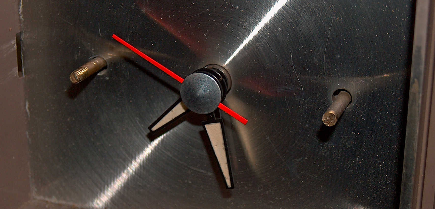

I am in the process of restoring a 60s Magnavox radio, on which the two plastic knobs on the clock dial have become detached.
One of the shafts these screw onto is threaded. For fixing this one, I was thinking of filling the knob with a bit of epoxy and sticking it onto the shaft so that, as it dries, it molds to fit the screw threads.
For the other, it is not threaded - looks like the shaft had a part that broke off inside the knob. For this one, I am not quite as sure what to do because the metal shaft it needs to attach back to is completely smooth. I could rub the metal down with sandpaper to rough the surface and then use the same epoxy strategy, I suppose?
These knobs do not simply flip a little electronic switch, they turn springloaded mechanical parts that require a considerable amount of force to move.
Advice would be appreciated!

They don't need to be removable, the knobs should be quite firmly secured.
There are the described left and right shafts.

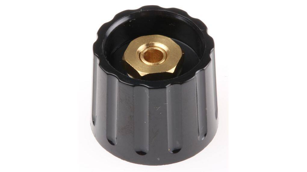

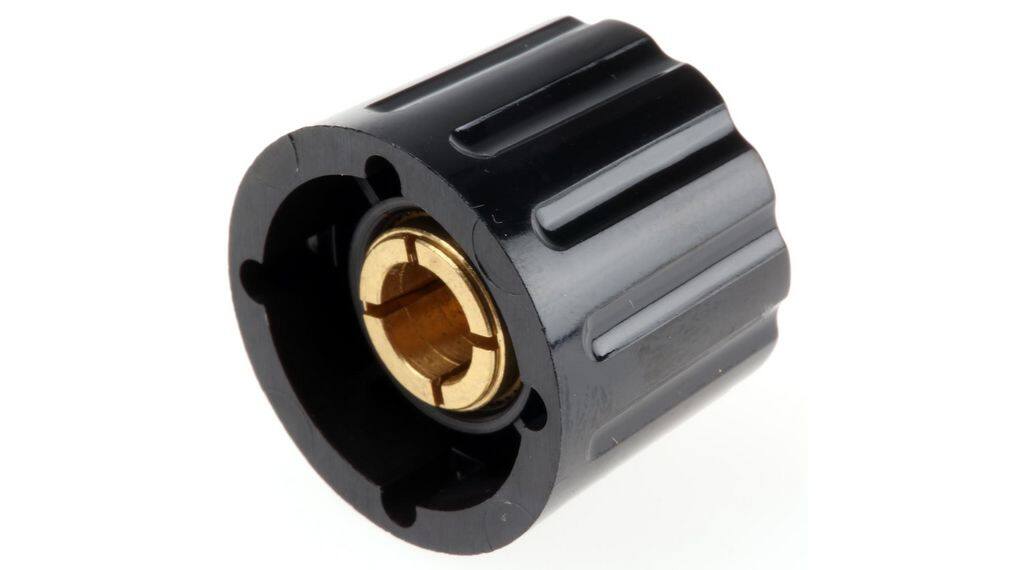

If the diameter is right there are off the shelf knobs that squeeze a "fork" as you tighten from the end, might work...

some form of universal glue (as long as the glue says it bonds to metal and the type of plastic you're dealing with, it should be good) will probably have enough strength to operate a knob as long as you make sure the metal is properly clean and just a but scuffed up. you want to sand the shaft length-wise so the score marks go along the length, not around, so they can provide additional friction.

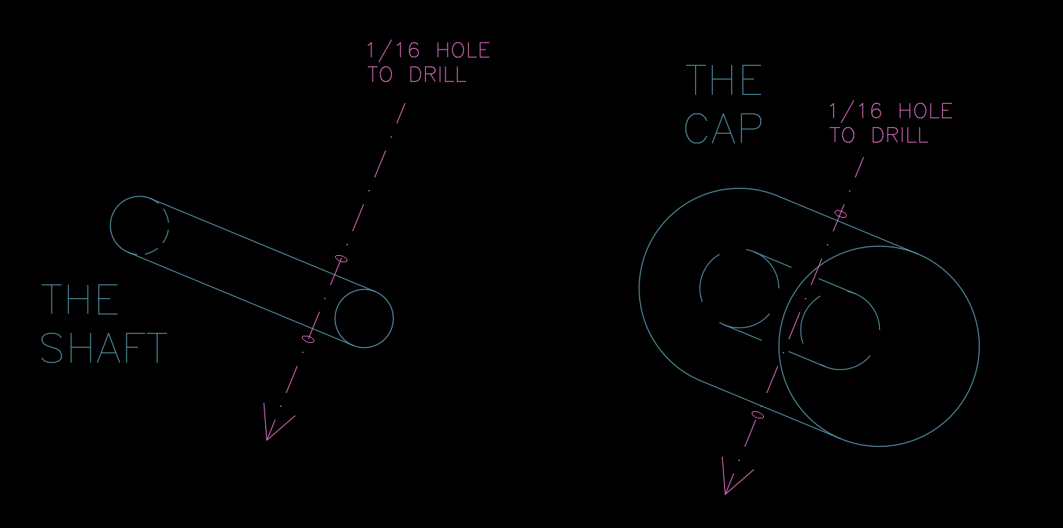

It would take a decent amount of precision, but my first thought is to drill a 1/16th inch hole in the shafts that also goes through the body of the knobs and then put a roll pin through that drilled hole. You might still add epoxy for added strength/rigidity, but that roll pin should help distribute the load into the aged plastic. (Do you have photo of the original knob?)
