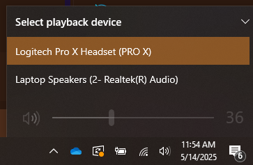

Personally I switch between speakers and headset using the settings (it works if you can have both outputs plugged in at the same time)
Right click the lil speaker on the task bar, choose the "sounds" option (thats at least whats its called in my windows language) and in the 1st tab on that lil window it lets me disable and re enable the preffered output to change what produces the sound
Ideal for me as well, but only useful if you have two independent outputs. I'm using analog onboard audio for my speakers and TOSLINK optical to a DAC for headphones so they show up as two devices and I can cleanly swap between them.
