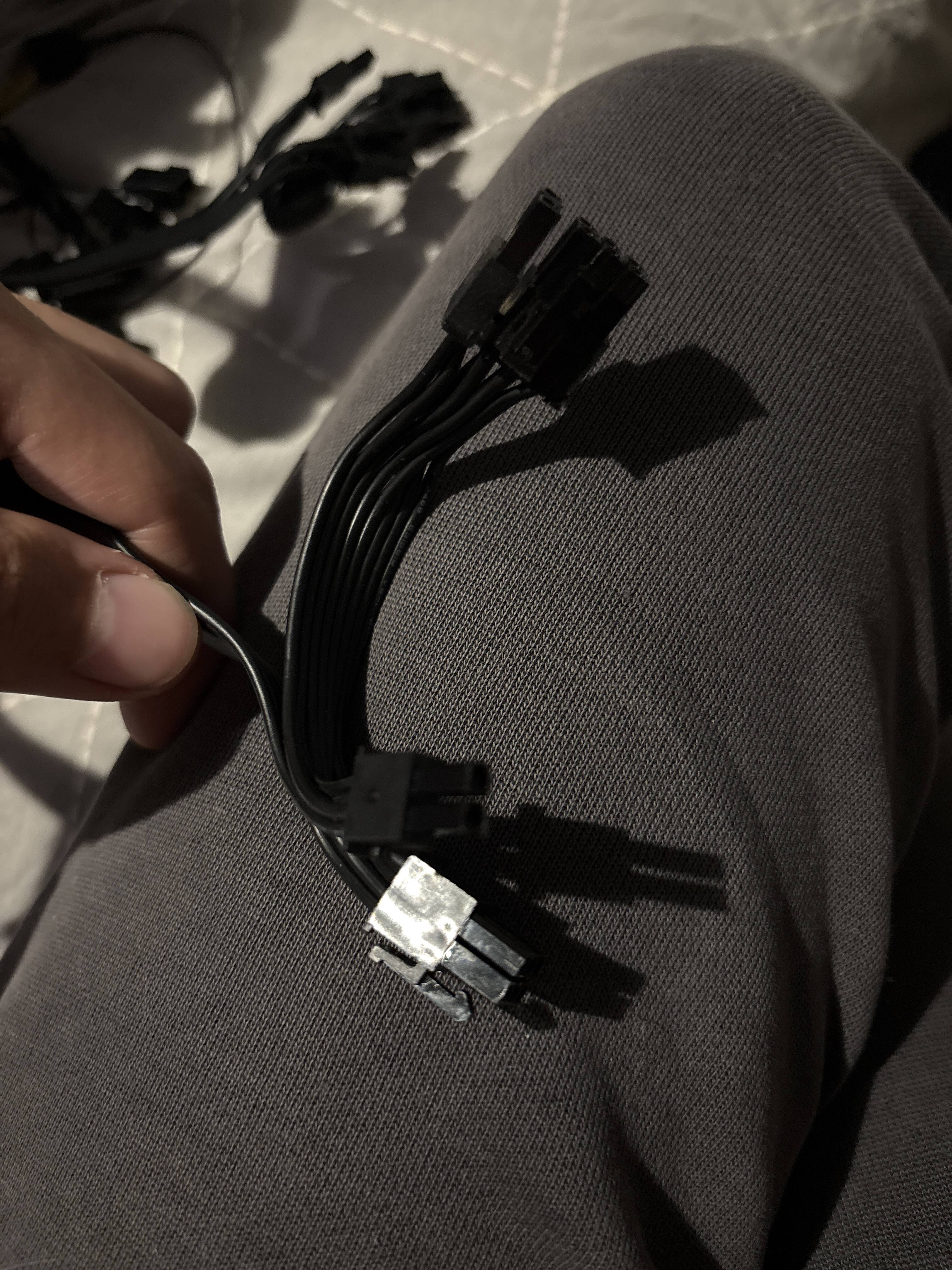

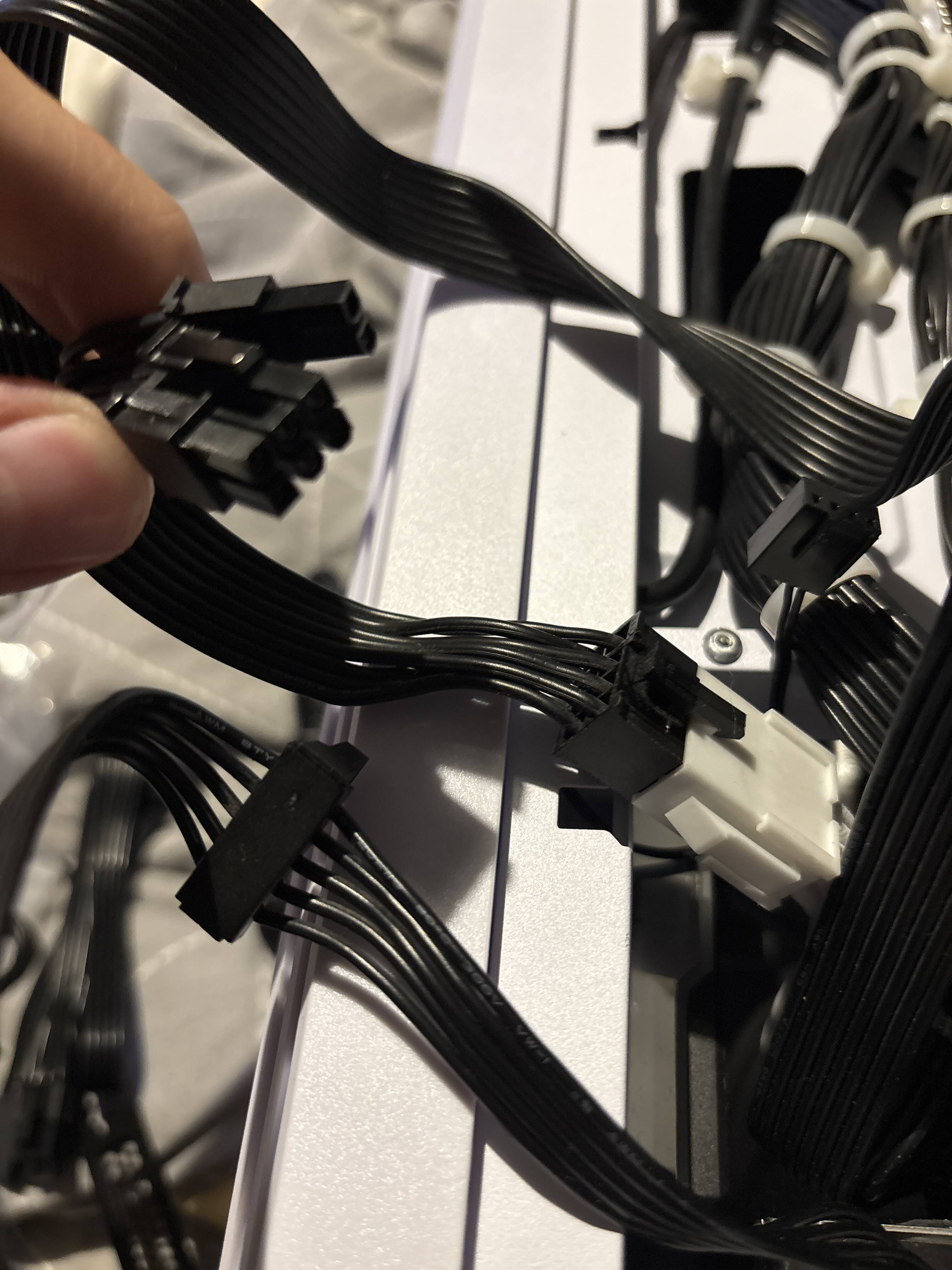

Please help.I just bought a unihub for my tl fans but i didnt see that you need a 6 pin connection to the power supply and the problem is i have only 2 6+2’s cables, both used on my gpu BUT they are double, so 1 6+2 actually has 2 6+2 connections as shown, can i use a spare one on my unihub or is it going to screw with my gpu.
Should be fine, but for the sake of cable management I'd suggest 1 cable goes to GPU, and 1 goes to the unihub (what is a uniub? a fan controller? why does a fan controller use 6+2 and not sata? or molex?)
Although it would help to know the models of the PSU and GPU.
yes its a fan controller dont ask me why it does lol, i used both cables as my gpu power because i was scared that if i used only 1 it would fry my gpu
Using a single cable shouldn't fry the GPU because the worst case is the GPU dosn't get enough power because the PSU can't supply enough power over only 1 cable. In theory I guess you could cause a problem with your PSU, but only if it was faulty already.
Anyway, given the wattage of the PSU, it should have no issue powering a 6800XT over a single cable.
i will give this a try, if i dont reply im burning

Just now, Snake45 said:
no, i thought so too but the ‘4’ cables came like this
Its not a terrible PSU so one cable for the GPU should be enough.
Its a 300w GPU and each 6+2 pin is rated for 150w, the GPU can pull 75w from the PCIE slot though.
Should be safe to use 1 cable with 2x6+2 for the GPU and use the other cable for the fan hub.
