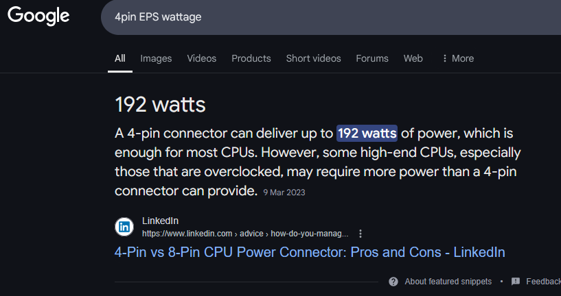

As far as 4pin power goes, it's actually enough for 5600x because that is a 65-105W CPU, more on the lower end of those 65watts.
