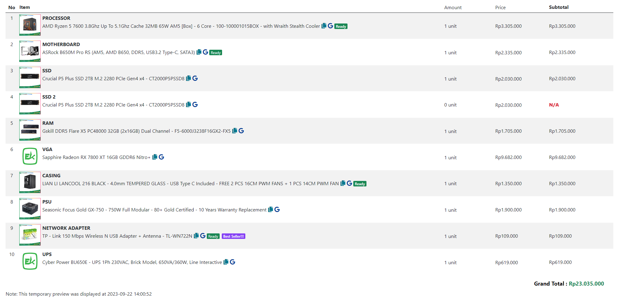

Budget (including currency): $1500 / around 23Mil IDR
Country: Indonesia
Games, programs or workloads that it will be used for:
  • Games: Multiplayer stuff (Project Zomboid, Satisfactory, or Sons of the forest), New-ish AAA Games: Armored Core, Cyberpunk 2077
  • Programs or Workload: VM and Coding stuff, Normal Multitasking and Browsing, Possibly Streaming and Video Editing
Other details: Gonna buy this probably in less than a month time, going for a no RGB build
PCPartPicker Part List: https://sg.pcpartpicker.com/list/rcFmkJ
Local Website PC Builder: https://www.enterkomputer.com/simulasi/preview/jmnGlU97
CPU: AMD Ryzen 5 7600 3.8 GHz 6-Core  ($215.00), Trying AMD stuff and free cpu cooler
Motherboard: ASRock B650 PRO RS ATX AM5  ($240.00), Cheap and most reasonable brand on my local pc builder website
Memory: G.Skill Flare X5 32 GB (2x16 GB) DDR5-6000 CL36  ($115.00), Cheap and QVL
Storage: Intel 660p 512 GB M.2-2280 PCIe 3.0 X4 NVME SSD  (Purchased For $0.00), Drive from my previous PC
Storage: ADATA XPG SX8200 Pro 512 GB M.2-2280 PCIe 3.0 X4 NVME SSD  ($36.00), Only buying this if i can't use my old SSD
Storage: ADATA LEGEND 850 LITE 2 TB M.2-2280 PCIe 4.0 X4 NVME SSD ($88.00), Cheap enough for a decent size SSD
Video Card: MSI VENTUS 2X BLACK OC GeForce RTX 4060Ti 16 GB  ($527.00), No particular reason so i'm okay with alternative suggestions
Case: Lian Li LANCOOL 216 ATX Mid Tower Case  ($89.00), Great case with great airflow and included fans
Power Supply: ADATA XPG CORE Reactor 850W 80+ Gold FM ATX  ($121.00), No particular reason so i'm okay with alternative suggestions
Wireless Network Adapter: TP-Link TL-WN722N 802.11a/b/g/n USB Type-A  ($7.00), Need it cause i don't think i can do wired connection
UPS: CyberPower EC650LCD  ($43.00), Unstable electricity on my area
Total: $1481.00 / around 23Mil IDR
https://linustechtips.com/topic/1532464-first-pc-build-spec-check/
Overall pretty okay, but you could save a bit more if you find products elsewhere, enterkomputer is good but their priced higher than some other shops.
4060 Ti for 8mill is terrible, 6800 XT is about 500K more but 27% to 33% faster in 1440p.
Maybe get a cheaper motherboard, there are some good ones for less, with built-in WIFI too.
IDK about the UPS, seems too cheap to be trusted for a PC of this caliber.
Thanks for the heads-up
Yeah kinda notice that after sometime, i am just using their website for convenience sake, with pricing and compatibility stuff
for GPU that's just a place holder and that's why i need some advice since i've been using laptops for the last 2 decades so i don't really know what's worth to buy right now
Looking at the pricing on mATX boards, i might switch, since it's very much cheaper
UPS was a product of 'Good UPS brand' google search, so i don't really know either

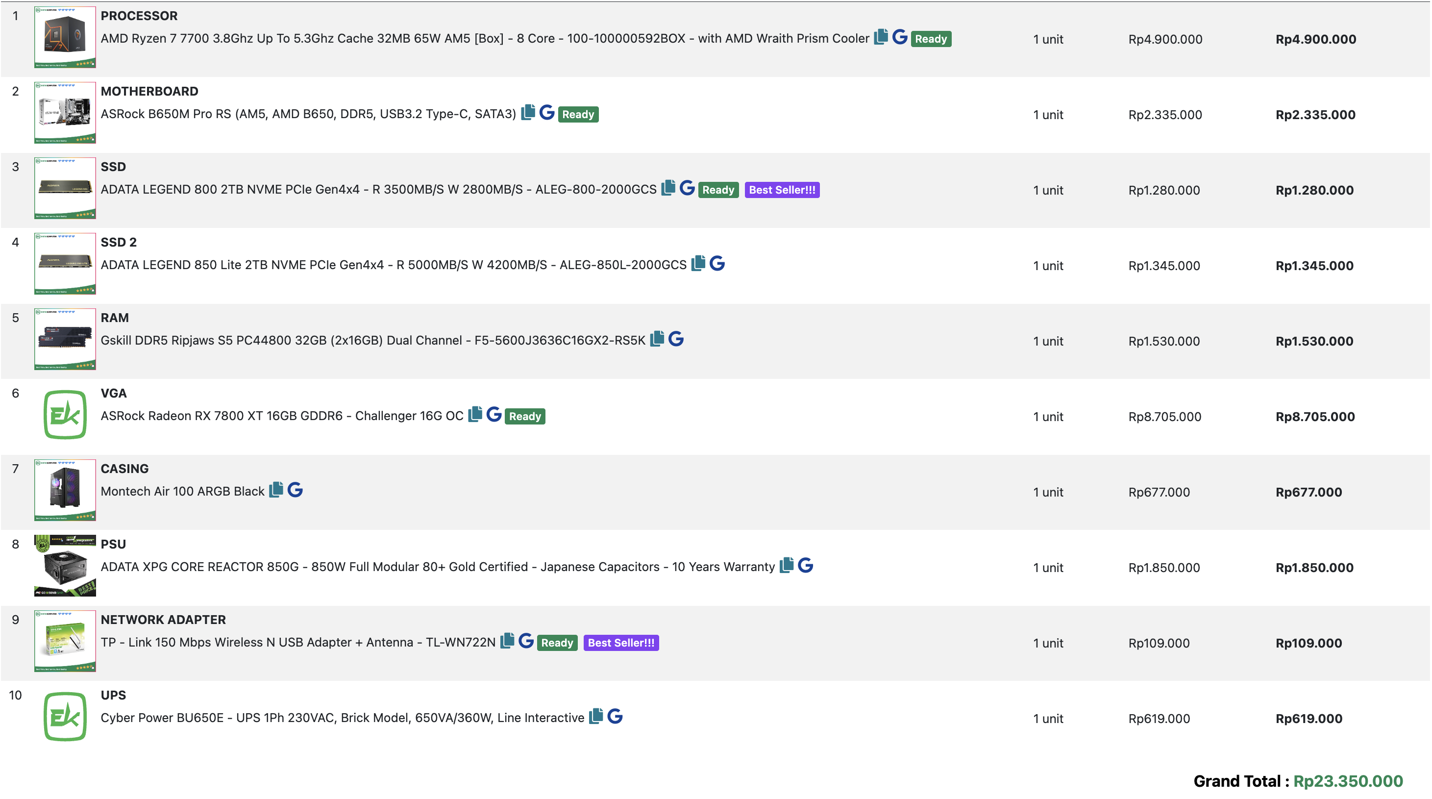

Made adjustments that combine some input from all of you guys, wdyt?
Granted it's not exactly on budget, like 300k-ish more, with price fluctuation and stuff
I upgraded the CPU to 7700
Changed to mATX config
Convert RAM to 5600 cl36
GPU changed/upgraded(?) to 7800 XT
2TB of SSD, with 2x2TB config
Oh yea that is much much better though psu is still stupid overpriced, the andyson unit is used but lets be real here itll still last 10+ years, new psus are not worth buying till you can get a 10 year warranty on them as all psus generally last 10-15 years, if it dies short of expected lifetime atleast you can warranty it but shorter than 10 years and used is straight up superior esp with that busted 1200w platinum for 750rb
Just get the rams i reccomended, even if it isnt c30 its still cheaper than those overpriced c36 gskills, and ram branding doesnt matter cause theyll all use the same hynix m/a die
Otherwise build looks very good and close to max price/performance
