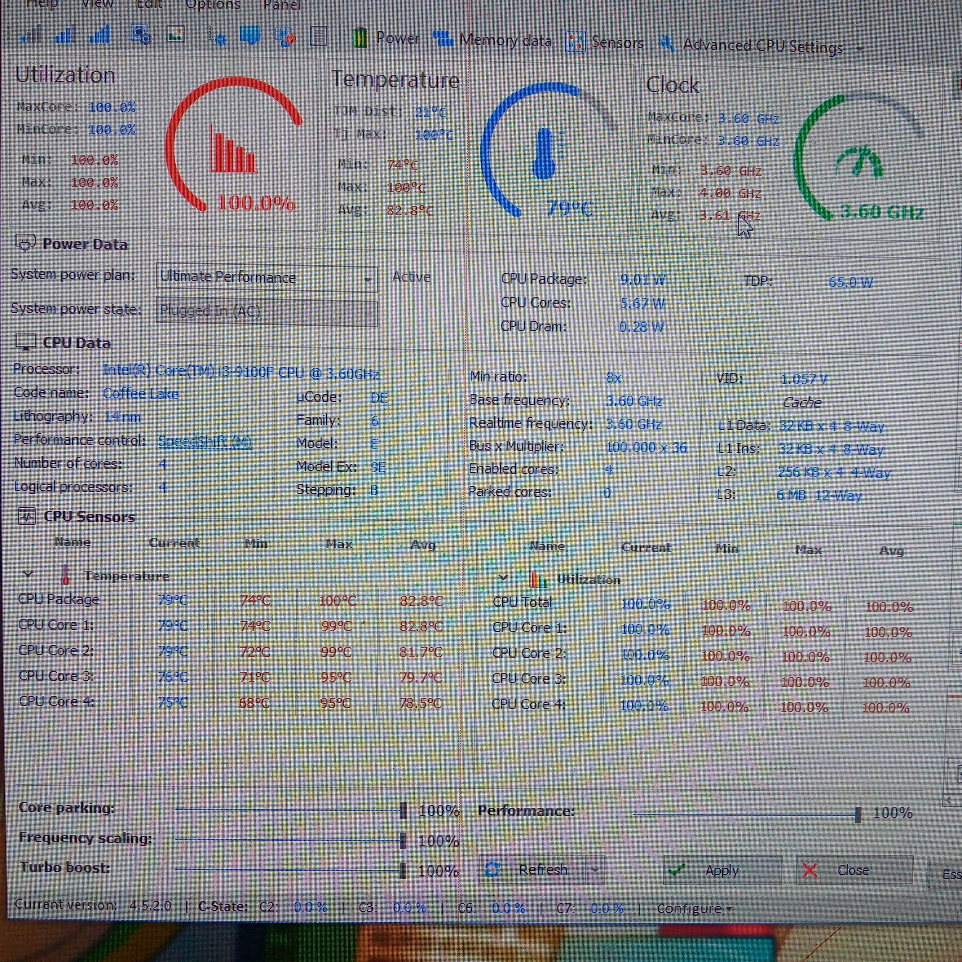

I have a weird issue where my PC won't boot anymore with 2 ram installed here ill explain
So I have
410m-pro MSI motherboard
With I3 9gen and 2x8hyperxfurry different model but they same speed and voltage used both for over an year so few days ago it just failed to boot I opened the case to see if anything wrong I saw the ez debug led kept looping from CPU to dram. So i removed one of the ram kit the A1 it just pass the CPU  and dram check  then it turn off.
I tryed removing B1 and leaving ram on A1 it back to looping between CPU and dram check it blink on CPU for half a sec and 2 sec on the dram and it keep looping like that. I did CMOS reset and reseated the CPU it can turn on fine if I place 1 ram on B1 but CPU have crazy heat like 100c on boot and 70c on bios if I turn the PC off it back to same issue

I tryed with the cooler it same issue when I turn off the PC I need to reseat the CPU and boot with A1 then off then remove A1  and place on 1B for successful boot I do have to repeat thise steps to get a boot
Update when I disable turbo boost I can run all game fine with 79-92c even high demanding CPU games as warzone I checked 2 cooling system both same results I am pretty sure that the issue is motherboard yes there is bent pins on the socket too I did bin them but idk if that got anything to do with ram and heating issue am not sure what faulty people say it could be power supply or motherboard IMG_20230919_160414_116.thumb.jpg.d3197d9127fffa953d2bba6801129a11.jpg

Bent pins can cause boot and ram problems, yes, but since the PC worked fine before, I would assume it isn't a problem (unless you did it recently).
