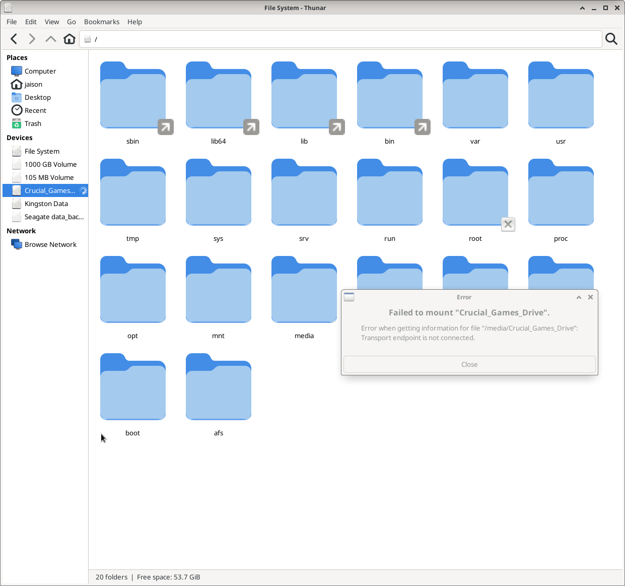

Here's a shot of an issue I was having. The access I had to the drive in windows would still be there but all the folders were empty.  Eventually it just disappeared altogether even in UEFI BIOS.
So probably a weird contact issue, i don't see anything else, i would have said a D.O.A drive but you said it worked on another port...
