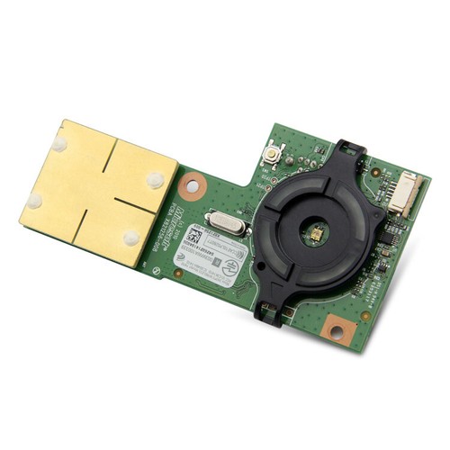

Just now, tjrose91 said:
the sensor has deep scratches on it so could be a short
Not likely as there is nothing to short there. This is what is behind that "button".
