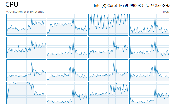

With Task Manager, go to Performance>CPU and then right click on the CPU graph and then choose Change graph to > Logical processors - this will show the utilization graphs for the individual CPU threads.
This was that graph through a benchmark
Note the bottom left graph: that's a single thread getting maxed out.
Some games, especially older ones, require better single-threaded performance to push more frames. More cores won't help.
What game(s) have you noticed this problem in?

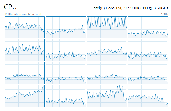

I ran the same benchmark again and got these results only 3 cores getting close to 100%

5 minutes ago, Phobosy said:
I usually just let the game decide what to use ut of DX 11/12
DX12 has better multi-threading support, so with your CPU, you should use it when possible. For some games like Cyberpunk, performance can tank on DX11 when a lot of NPCs are around, because the engine struggles to simulate them all on a single thread.
Edit: And that's probably why Cyberpunk's dev team didn't even try to get DX11 working on PC. The game would've been even buggier and slow than it already was at launch.
