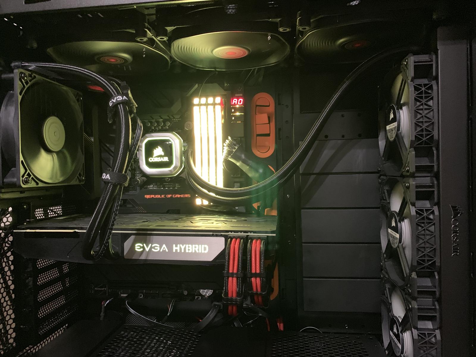

I agree with the others but I would also suggest a different case for better airflow since it might get pretty toasty in there
Airflow through that case should be of no concern, you will see this can be substantiated once you get a look at all the fans....
