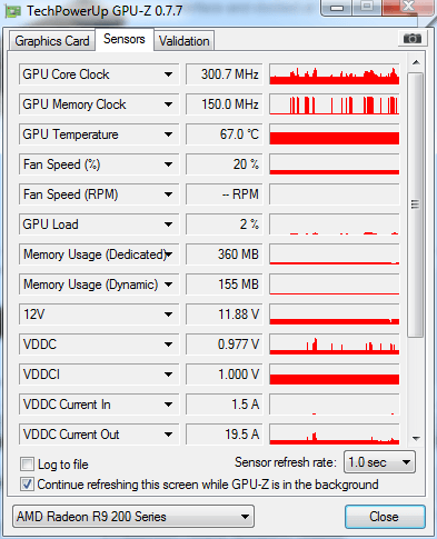

@SkilledRebuilds does this look normal to you:

Idle temp of 67*c is pretty high...
Im idling at 45*c-50*c, have any fans in front of case pointing towards gpu?
Side panel fan ability? If possible adding some more airflow to the GPU will help a little...
Seems too high, I' be RMA'ing it if I saw 67*c idle.
I've got 4 fans on the side panel all pointing at it, it doesn't really help.  I'm probably going to return it and get the Tri-X or DCUII.  :(
Yeah sounds about right, as it seems with your card, something isnt right....
I'd be Swapping/Dealing with it as you are, its just not operating within "normal hot" operation.

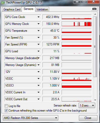

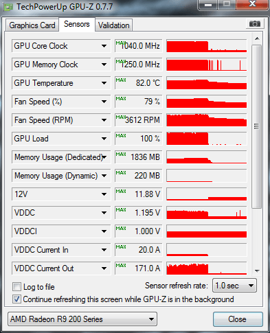

@SkilledRebuilds, I changed to the 13.12 drivers and I'm now idling at around 45C at stock speeds and 82 at load:

Looks perfect now mate, fucking good job :) Seems the driver change fixed it. Fan profile looks good, you could even extend it further if its too noisy still, although I'd not like anything above 85*c max  on the core, thats just me.

Thanks a lot for your help, it's really appreciated!  My card seems to be working as expected now, my idle speeds are usually 50C at 5-10% load which seems acceptable.  I'm yet to monitor VRM temperatures while gaming yet so fingers crossed for that one.
