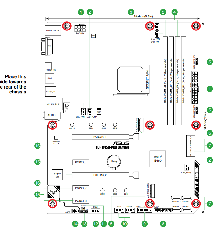

This is a layout from the manual of your motherboard. Assuming I've read it correctly the part labeled "5" is your RGB strip port. You plug the rgb strip onto the 4 pins and it should appear in your aura sync software
I cant do that cuz the cables are completey diferent to the socket. =(
you bought 5V (3 pin) Addressable RGB LED Strip (each LED or section) can be different color. But your motherboard support only 12V (4pin) RGB (whole strip is one color). So if you want use RGB on your motherboard you need to buy 4pin 12V RGB strip
What can i use this strip for then, is there an adapter or something?
Sorry i don't know about anything. you could buy some RGB hub (terminal) but it will be more expensive, you should return this if possible and buy correct one
