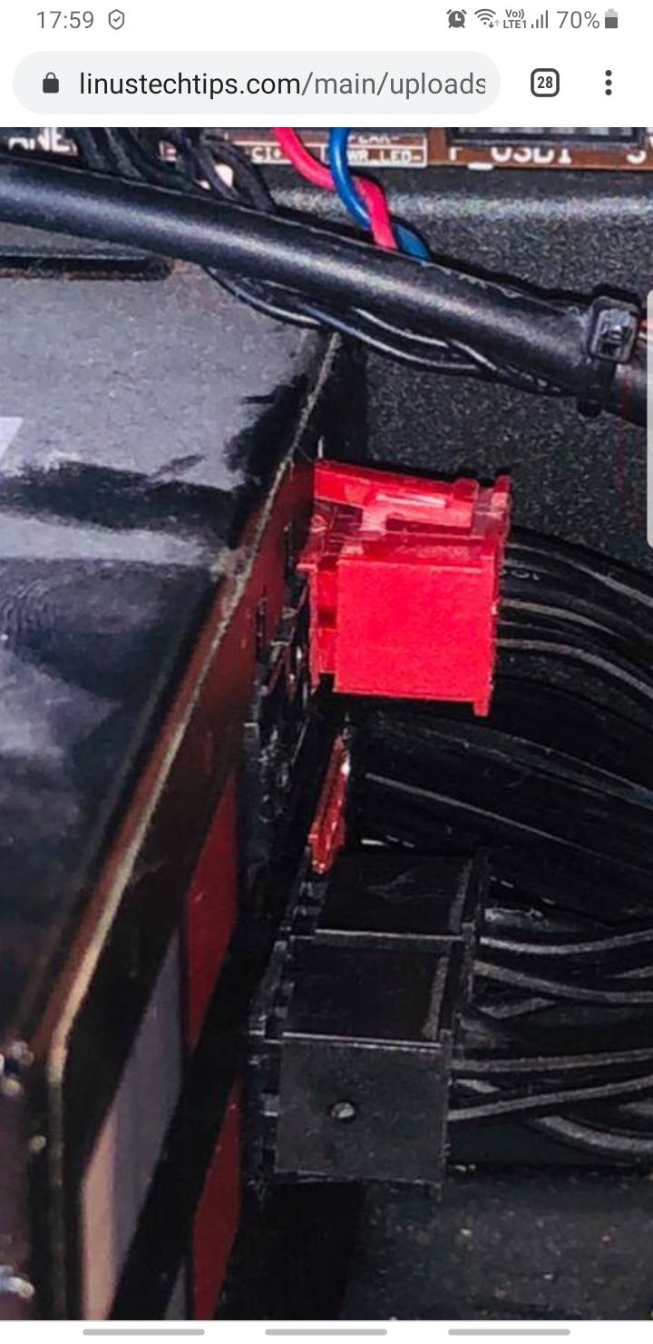

Hello,
since three days my PC is not turning on nor posting, instead it is just making a clicking noise every approx. 3 seconds...see the picture... the red circled one that is the “thing” that is making the ticking noise. Has anybody have an idea what this cable might be ? Or what is causing the problem?
thanks in advance

That's the PC speaker...
Looks like a bootloop. Might want to try and clear CMOS, possibly check/replace the CMOS battery.

PC Speaker indeed. Also looking at the PSU, seems the top red PCIE cable isnt plugged in fully.

Technically its not actually a speaker, its a Piezo Buzzer.
Good catch, but actually all of them aren't fully inserted ?
So yeah, first thing to address.

Push them in till they click..and yes the circled part is a buzzer that beeps when there's an error by the different tone it tells different errors(which I have no idea what they are)...haha

Thanks for the responses and sorry for my late responses...
I checked every kabel and took out the CMOS battery for 5 min from the motherboard but the computer stil isn't posting.
dose anybody have an idea why... what should be replaced... a fix ?

I had a problem like this once, but with a buzzer, for me it turned out to be a bad ram stick. I tested it by removing one ram stick at a time.
