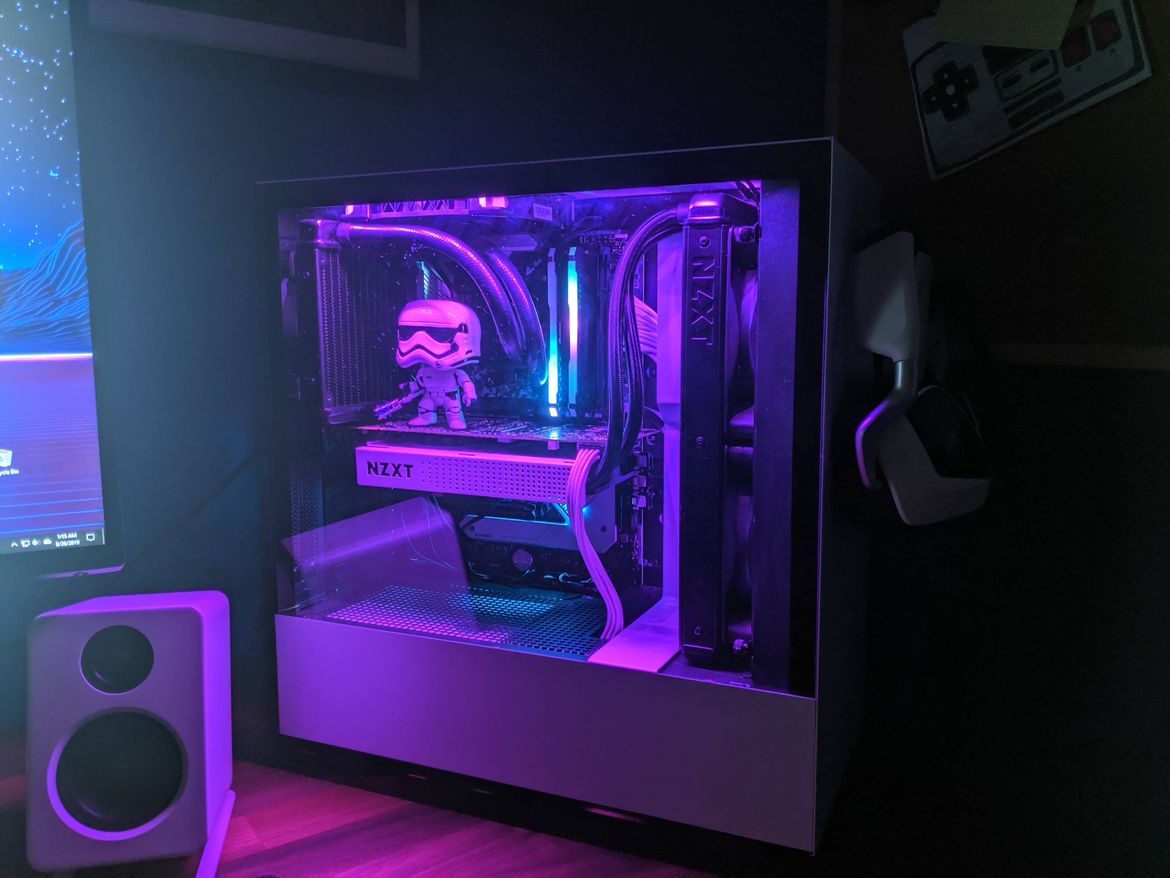

Posted August 26, 2019 Author 9 minutes ago, quakeguy said: Yep! I've read about errors like this happening if you have your RAM installed in A1 & B1. Here is some of my case porn for you! NICE! I'm not sure mine is quite as neat. Here's a comparison, with RAM in the wrong slots and all! Also, I'll update here after reseating the DIMMs. Link to comment https://linustechtips.com/topic/1098088-how-to-use-3200mhz-ram-with-a-ryzen-5-3600/#findComment-12840929 Share on other sites More sharing options... Link to post Share on other sites More sharing options...
Posted August 26, 2019 Author Thanks! It is indeed the H500 (well, technically the "i" but it's all the same thing.) I love a clean white canvas to splash pink and cyan all over, haha. I might just post there! Feel like I'm going to be part of this community for a while. Anyway, I'm pretty sure this is solved. I reseated the DIMMs and I'm running a Blend test, and getting zero errors. I'll probably run this for a couple of hours, try out some gaming, and if I have no other issues, call it a day. Thanks so much for the help! If anything does come up, I'll probably be back. Link to comment https://linustechtips.com/topic/1098088-how-to-use-3200mhz-ram-with-a-ryzen-5-3600/#findComment-12840942 Share on other sites More sharing options... Link to post Share on other sites More sharing options...
