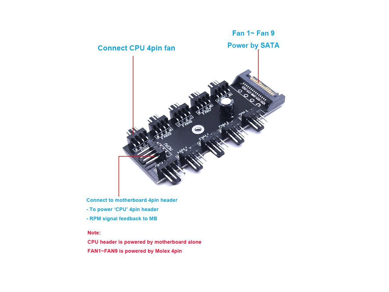

I ordered two of these.  Will they do the job?  Its two rads, one 360 and one 480 (push/pull).
https://www.newegg.com/black-en-lab-2ft-60cm-pwm-4pin-fan-hub-splitter/p/1W7-005X-00042
https://linustechtips.com/topic/1090691-multiple-fan-support/#findComment-12781195
Powered splitters would be the best option. That way you're not drawing too much power from the PSU but you still have some illusion of control from the motherboard. That doesn't mean that they will work correctly but it's the best way to get "full power" from the fan.
https://linustechtips.com/topic/1090691-multiple-fan-support/#findComment-12781202
Hell yeah, that's exactly what I had in mind.

Aight cool.  Thanks so much for the help.  I thought I read somewhere else hooking up too many fans to the mobo could kill it.  Do you think I would have that issue hooking the fans to those two hubs and then the hubs to the mobo?
https://linustechtips.com/topic/1090691-multiple-fan-support/#findComment-12781507
The hub comes with a sata power connector for that reason. You plug it into the psu for auxiliary power.
https://linustechtips.com/topic/1090691-multiple-fan-support/#findComment-12781573
Sorry I have never done this and don’t wanna mess it up.  So the sata will get plugged into the psu from the hub and then something else plugs into the mobo?
https://linustechtips.com/topic/1090691-multiple-fan-support/#findComment-12781591
Yes, there's a cable that connects the MCPU header to a fan header on the motherboard.
https://linustechtips.com/topic/1090691-multiple-fan-support/#findComment-12781599
  Reveal hidden contents
So the fans are powered by the psu from the sata but the signal is sent to the mobo from the other connection.  Sorry last thing lmao.  So I will be able to control fan speeds with this?
https://linustechtips.com/topic/1090691-multiple-fan-support/#findComment-12781817
Yep, you can control the fans using the motherboard settings.
