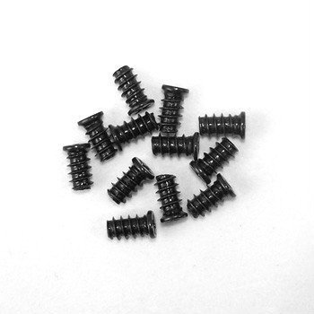

What kind of screws are you using? Standard fan screws are self-tapping. The first time can take a bit of force since the threads aren't cut into the fan frame yet.

I'm using the long fan screws that came with the case. There's also other screws that fit, but it's the wrong way and it's way larger than the holes in the fan.

The long fan screws are only for mounting fans at the front of the case where the screws thread into the case and not the fan.
Like this: https://techreport.com/review/32751/corsair-carbide-series-spec-04-tg-case-reviewed
For the other fan mounts in the case, use the shorter fan screws that come with the fan or case.
They should be like this:
What do you mean by the screws being the wrong way?

As in the screws are too short to go through the fan and then the chassis.
The screws are supposed to go through the chassis and then thread into the fan.
