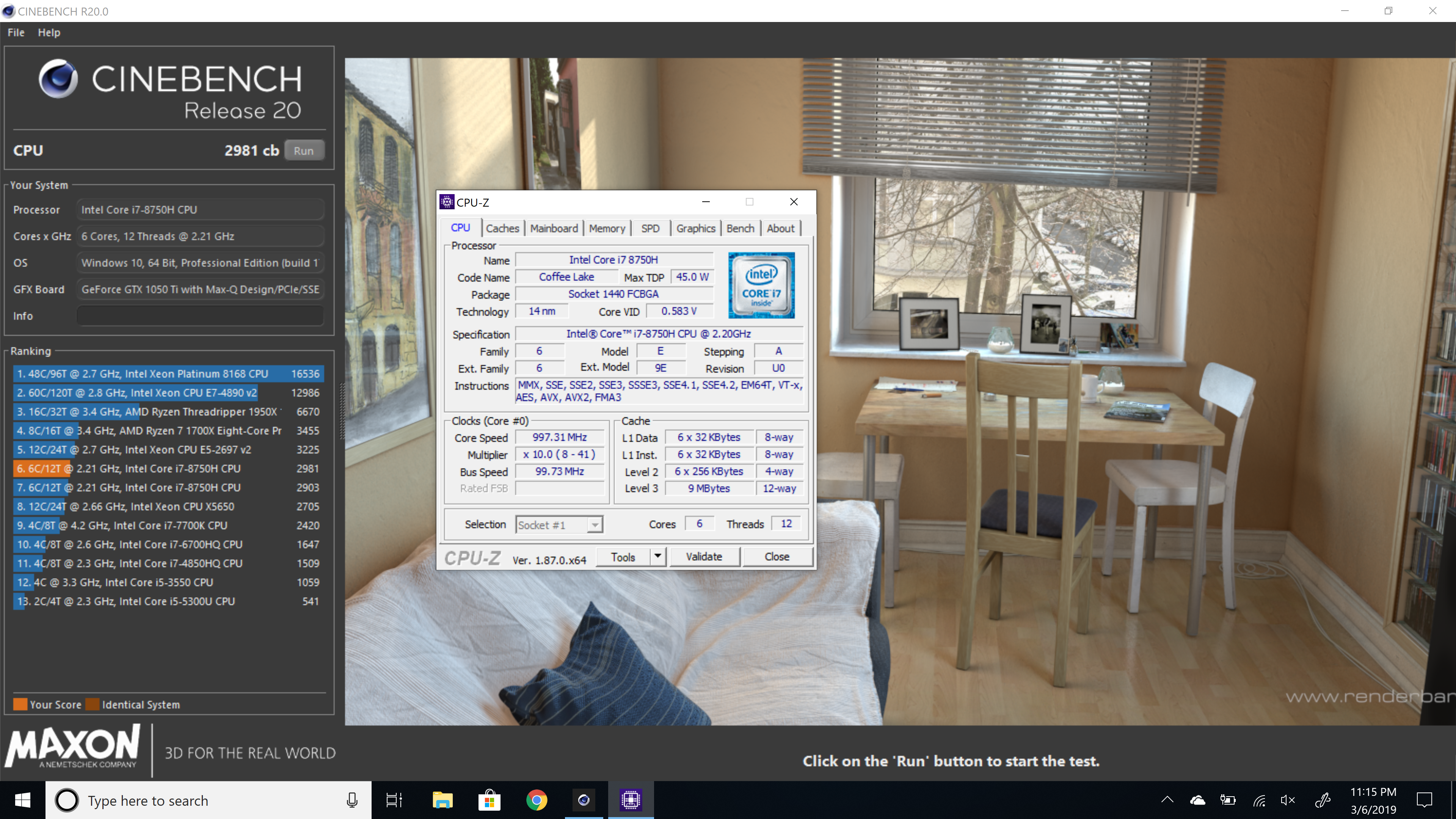

about 2400 by disabling PL2 (so 45w package power all the way)

10 minutes ago, Saksham said:
how do you disable pl2?
and what is that?
throttlestop
it's a short duration power limit. PL1 is the long duration power limit shown as "TDP" in the official spec page.

4 hours ago, Saksham said:
@Jurrunio @X_X
holy shit i just got 2481. i ran it yesterday i I was getting 2350ish. thats faster than a stock 7700k.
I mean, it has two more cores, even if they aren't that high frequency.

9 hours ago, Saksham said:
@Jurrunio @X_X
But your still 20% lower than Arm3nian's score and given how low increases in performance has been over the last several years that's a lot.
Have you undervolted core and cache? From what I have seen these chips can manage more than 100mV undervolt. If it was me I would also look at the possibilities of increasing power limits, what does HWiNFO CPU tab show as maximum allowed power?
how do i check max power allowed in hwinfo?
I have no undervolts. no power limit increases.

10 hours ago, Clasmir said:
Curious if this is in the ball park for a 9600k running @ 4.9Ghz. I was a bit disappointed at only 4.9Ghz on a closed loop water block.
1
that does not seem right at all. I have a 8750h which is a laptop 6c/12t cpu with 2500 points. something is wrong with your 9600k
https://linustechtips.com/topic/1045880-cinebench-r20/#findComment-12425910
So you have a lower score with a 12 thread and you think my 9600K has a problem?? Keep in mind I'm overclocking my 9600k. I doubt you are doing that with the laptop. So it isn't unreasonable that my score will be higher than yours by a fair margin.
https://linustechtips.com/topic/1045880-cinebench-r20/#findComment-12426275
that's where i am not sure. 9600k and 8750h have pretyy big differences in performance. only 300 points difference does not sound right. your score should be higher... like, a lot higher. but then again, r20 is new and scaling might be different. 2500 to 2800 is only like a 8% difference when it should be well above 20% higher.
