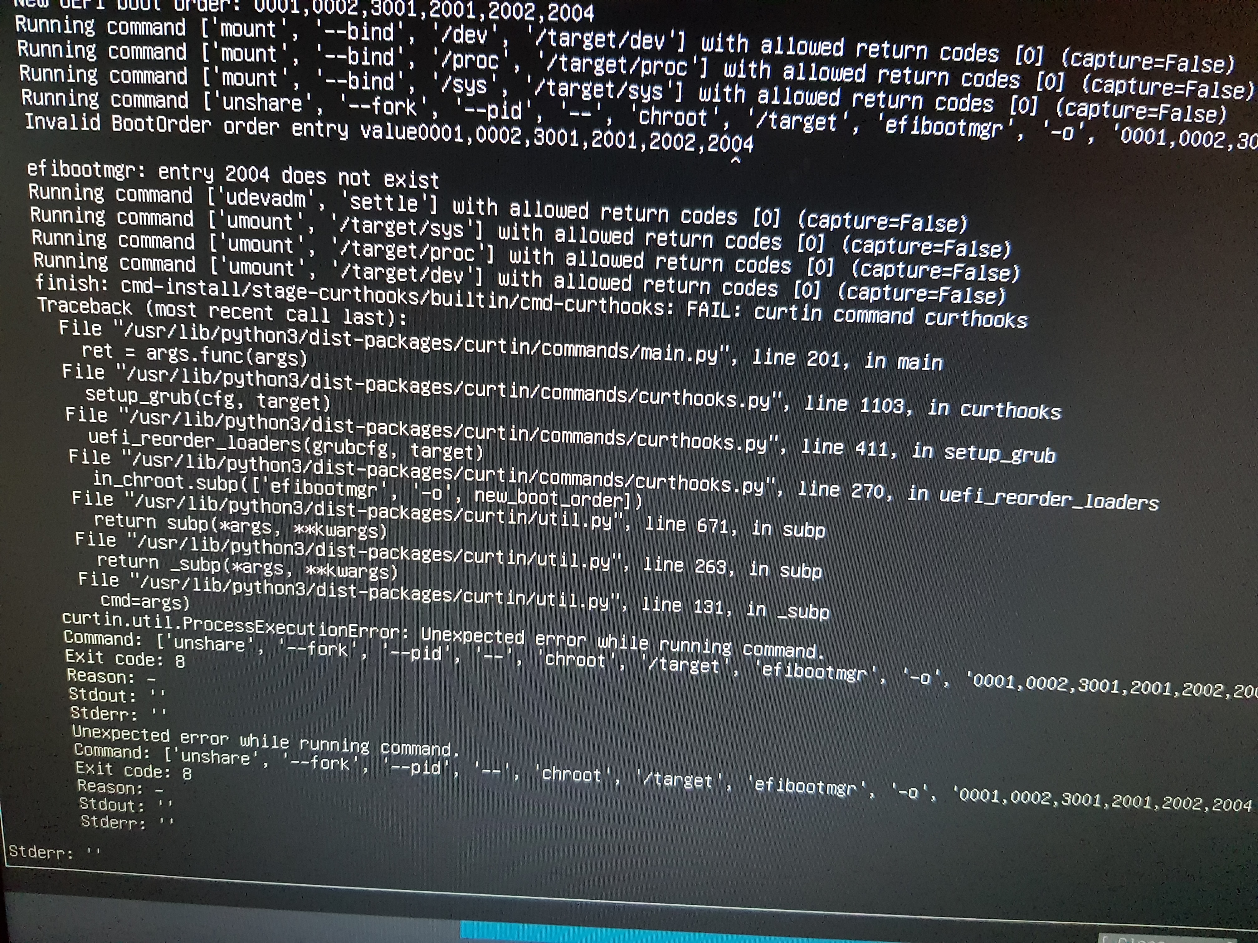

14 hours ago, Cupar19 said:
so i want to install ubuntu server onto my laptop that has no display, so no bios access.
but it always fails at the grub install
so how do i install without grub

Is the image you are using to install uefi capable? Does your laptop support uefi? Is secure boot enabled?
Load into a live environment and do a list of the disk partitions. The boot partition for a uefi install should be GPT.
You should also be able to use the live environment to manually install grub.
edit: actually looking at that image again it looks like one of the entries in the boot loader config might not be correct. Try doing a reinstall of grub
Ok I'll try
