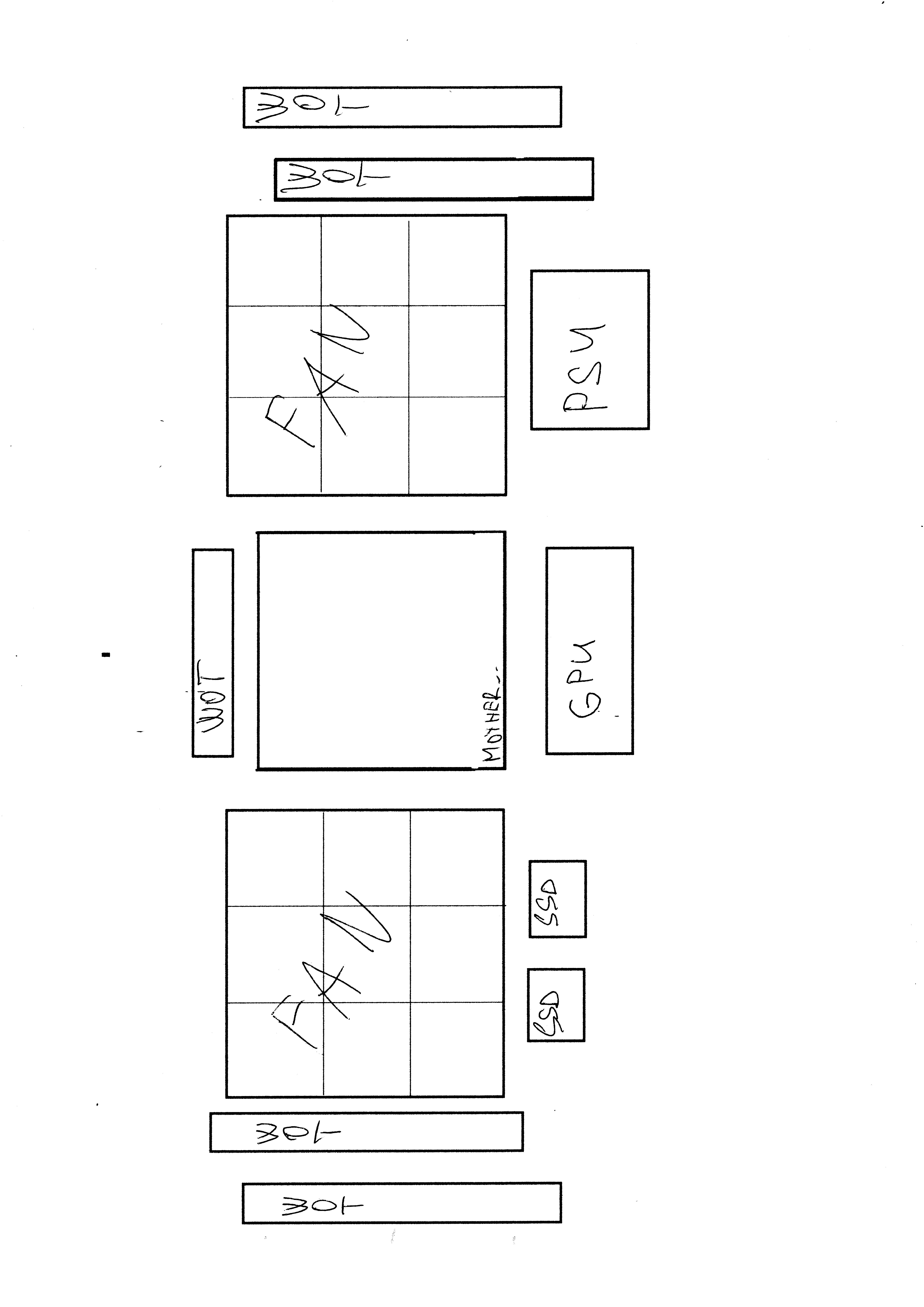

hi heroes!
i need professional help :-) with my project .
wall pc custom case 155cm x 75 cm x 20 cm
gtx 1080ti
 EVGA Hydro Copper
8700k  (water ) cuplex kryos NEXT VISION
4x 360mm radiator (for  120mm fans)
2X 240mm radiator
2x12mm radiator
3x Syscooling SC-P90 1300L/H
4x 50mm/400mm water  tank
motheboard .......just no idea ...z370 or new z390
corsair dominator platinum 64gb 3333mhz
power adapter  rgb   just no idea ....
18x rgb fans
and this ist problem ! because i need pure sync with light and speed
my favorite Aigo aurora C5  but max is 10 fans on one controller and other companies  no better solution?
thanks for every answer and idea!!!

Don't understand "sli (water) no on motherboard ! problem with sli bridge . . .". Could that be explained a little better please.
Why do you have eight 360mm radiators?
The case is huge! I guess that is why you have two pumps and four tanks?
https://linustechtips.com/topic/933406-beast-wall-pc/#findComment-11404603
With this sort of cooling is is not possible to cool below the ambient temperature. One could have 100 radiators and coolant temperature will never get blow the temperature surrounding the system.
Nothing wrong with what has been outlined, it just will not be much more efficient than a couple of 360mm radiator..
You might consider the Asus Maximus X Formula. The MOSFET heatsink can be incorporated into a custom loop for even better cooling. The motherboard has good Aura Sync support so you should be able to control all of the RGB from the motherboard. Check https://www.asus.com/campaign/aura/us/index.html for details. The Partners and Promotions link will provide a list of various 3rd part products that are compatible.

So you seem to be the only one with that SC P90 pump. How does it perform vs the D5 since they claim it to be stronger than the D5 much like Alphacool's VPP755 at 23W
Have you thought about adding a second loop outside the house connected via a plate heat exchanger ( liquid from one loop won't mix with the liquid in the second loop ).
I'd think he already knows you can't go below ambient temperature but he can drop the delta T to within 1-2C as per video.
 Graphics card temp with the fan on was only 26C and fan off was 28C.
