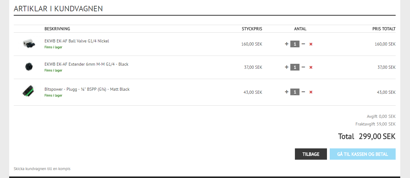

yeah the clearance is no problem, i have plenty of space in my case. so this would be all then?c2f7a4e9464cdb3786d26044ec81f403.png

Yep that would be it, I would suggest to get an extra compression or barb fitting and short length of tubing if you don't have some already for draining the fluid from the valve far outside the case.

okay so the items above + https://www.coolerkit.se/shop/bitspower-g¼-13mm-4071p.html and then im all set to go? great!

Yep just make sure that's the same ID as the tubing you have on hand and your good to go.
