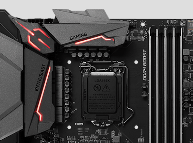

Aesthetics sometimes can harm the performance of a part. Like for example, here's a heat sink from a gaming motherboard:
Compared to a heat sink from a server motherboard
The problem with the gaming heat sink is it goes for looks over performance. The shroud over the heat sink restricts airflow that can go into it, practically necessitating the need for a downward fan on the CPU heat sink if it wants any real amount of airflow through it. Whereas the server heat sink is open, and is less restrictive of how air can go around it.
That's just one example. While looks are nice, if it looks like it can hamper performance, that hardware should be dropped.
