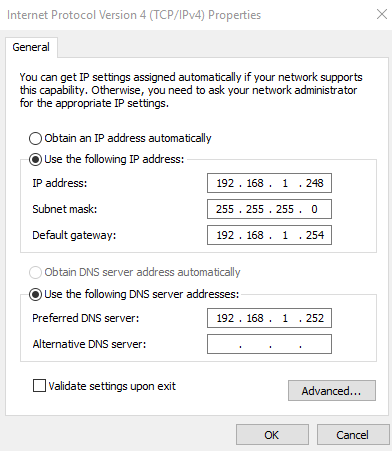

OP, make sure that if there is DC (Domain Controller) in the network, that the IP of the DC is entered as well in the IPv4 section.
If he has some type of router, tell him to change the settings.
Like this:
