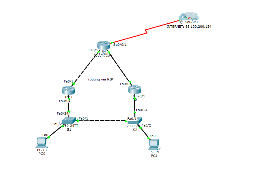

Okay Here's the diagram.
If the interface F0/1 on R1 went down. How would I get the IPs.
https://linustechtips.com/topic/804943-hsrp-issue/#findComment-10115502
It should go out Fa0/1 on S1 instead of Fa0/24 and then over and up

https://linustechtips.com/topic/804943-hsrp-issue/#findComment-10115506
Mistake. I meant F0/0. Sorry :P
EDIT: Talking about the router on the left.
https://linustechtips.com/topic/804943-hsrp-issue/#findComment-10115507
Ah, then it would just go out Fa0/24 on S1 and up. So long as the link between the two switches doesn't go down along with a link to the router you're still good.
