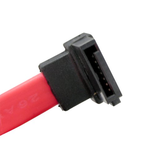

1. Get appropriate cables. You need a SATA data cables. SATA power should be provided by the PSU (look inside your case, the bigger one that connects your HDD is power, the next to it smaller is data). Not sure if Samsung includes it or not. Not sure if your mobo still have spare ones. Connect SATA data from your motherboard to your SSD just like you did with the HDD
SATA DATA
Image result for sata data
SATA POWER (note that there are many wires coming to it not one solid stripe like the data)
Image result for sata power
