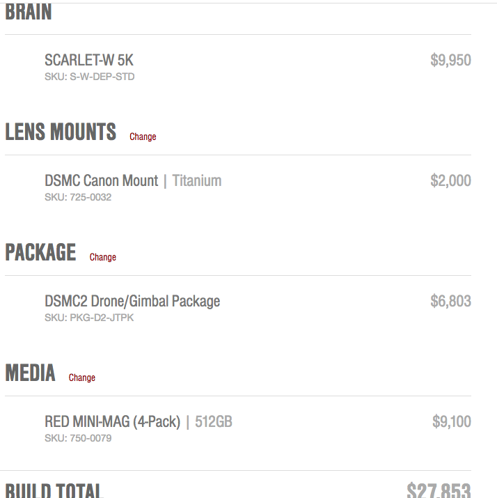

Firstly, I'd like to point out that if you need to come here for advise with no sense of direction yet, you probably shouldn't be working with a $560K budget and a "client".
This is what I've put together for you for fairly cheap:
That's RED's own configurator thingy.

I agree with your first point and am confused why someone with very little experience would be given such a task.
As for your list of parts, I can assure that is only the beginning.  The DSMC drone package you selected is not enough to mount a RED camera on a drone and start using it.  It's missing a wireless video transmission system for the drone operators to monitor what is being filmed.  And with a RED camera it will require at least two people to operate and film with a drone.  One person to focus on flying the drone and at least another person to operate the camera and lens, gimbal movement, etc.  The lens will require a wireless follow focus (and perhaps zoom) control system if the operator does not want to rely on autofocus with the camera.  Adding all these accessories, it even the lightest RED camera package could end up weighing at least 5-10kg and will require a drone with sufficient lift capacity.
