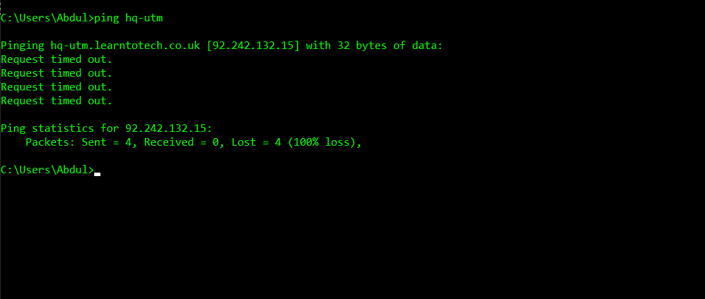

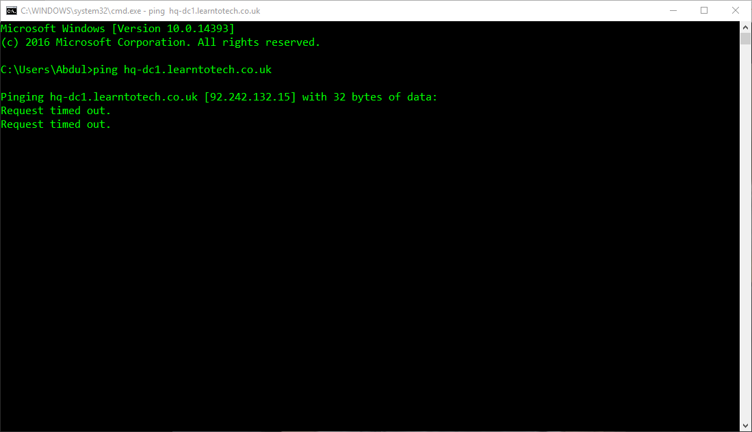

Hello guys. So I'm facing a problem where I cannot connect to my server by writing the fully qualified domain name of my server. Which is hq-dc1.learntotech.co.uk. I can ping and get a response by pinging the server's name.
This is the ping:
Also my Sophos UTM

What you show in the screenshots is
1. you pinging a FQDN which gets resolved into an IP, ping times out.
2. You pinging a short address which gets resolved into a FQDN, which in turn gets resolved into an IP, ping times out.
Now, is 92.242.132.15 the correct IP address for your server?
If it is, then again, this is not a DNS issue.
How did you check that there was no DNS record?
Do you run the server yourself?
What I got wrong at first was that the server would respond. It actually doesn't even respond to the pings in the screenshots.

So the 192.16(8?).1.x is NATted to the internet while you should access the server via 172.16.105.x?
Now, the FQDN resolved to 92.242.132.15 which is probably your public IP, and whatever the public IP hits in your network didn't respond to ping.
If you mean you didn't have a DNS record for the server on your personal DNS server that should resolve the FQDN to 172.16.105.x, then I do understand. It didn't find the record there so it went on to find it in public DNS, and found it too.
Is it now resolving to 172.16.105.x after adding the record?
Yes. Although the 92.242.135.15 is not my IP. It's http://barefruit.co.uk/ resolver. Also, I can resolve both IPs of my server.
