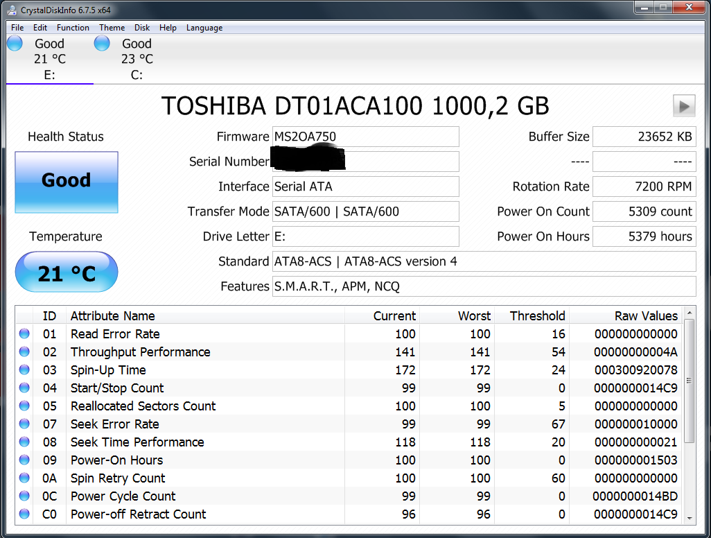

I checked the HDD with CrystalDisk but there appeared to be no problem. I can still use the pc like I do everyday, but it is very possible that the HDD kind of "disconnects" on some random point while using the pc.

https://linustechtips.com/topic/565329-hdd-constantly-dying/#findComment-7435245
Please post all values and not only the top ones.
The shown values are not indicating any errors.
Try to use a different sata port on the Mainboard and a different connector from the Power supply (preferably from a different cable)

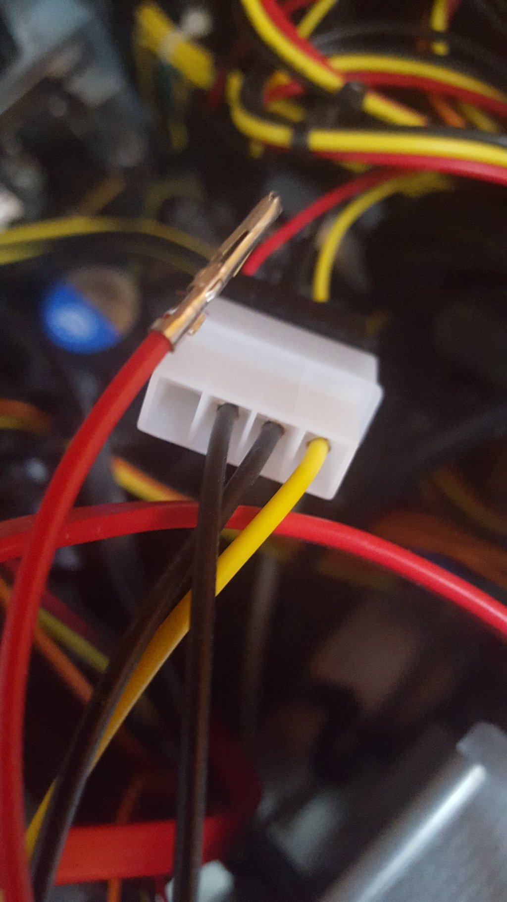

I guess I found the problem ^^
As I've said I did check all the cables, but somehow I didn't see, that one of those pins lost connection. Some minutes ago I moved the pc and the cable finally fell out so that I could see it.
I guess this explains everything, right?
Kind of. If the hard drive doesn't have enough power, it obviously can't spin up.
That's, why i asked you to check all cables.
