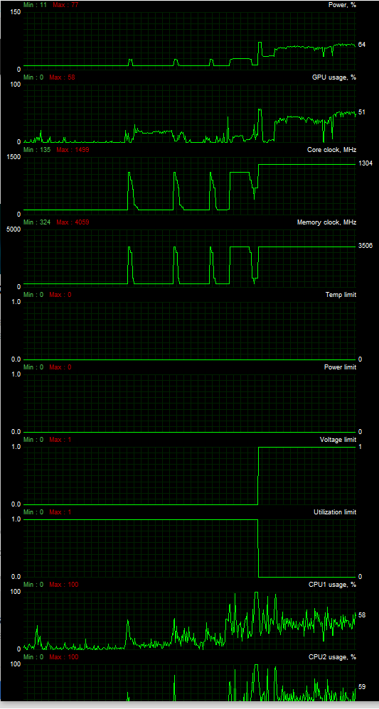

I have a GTX 970 Strix, and I'm having a problem for some time, tried to solve it 2 times, couldt and just gave up... Now trying for one last time. My core clock isnt stable while Playing games... It should boost to 1499Mhz, but in some games it doesnt go there, even without v sync or some fps limit. Like per example, playing diablo i had this graph in msi afterburner 8d8c5764affce85e9f634be2ebade0ee.png
In ESO it goes to 1300 or something... And now I've been messing with some stuff like registry and NVCP and the core clock stays always at 1113Mhz, doesnt go down! Please I beg for help

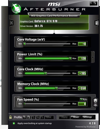

i think that is not this case... I jsut noticed this when I installed windows 10... In windows 7 I think this didnt happen
THis is my definitions in MSI, power LImit was always at 120cdff4adf69523c043b1b73e9b95a50da.png

1 minute ago, nunocv said:
I just played now, and it went like this... I dont understand, this is some wierd stuff
Yeah that all looks normal.  Keep an eye on it though - next time you see the core clock dip, I want to see the utilization charts (also you didn't actually show any of them) ;)

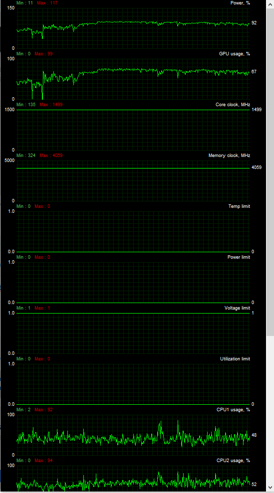

Diablo Running in the background, take a look at this...
I've never seen the graphics like this in a long time, really really long time, always had strange downclockings throughout.
1 hour ago it was at 1300 Mhz playing Diablo, just changed what I said in the post before and now is like this... WTF I'm mind blown

https://linustechtips.com/topic/545974-core-clock-problem/#findComment-7219870
yeah looks good to me :)

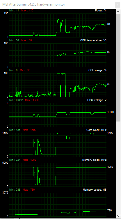

What means If the Utilization LImit is at 1?
It means the card isn't working as hard as it possibly can.  Say for example vsync is turned on, it will show a utilization limit since it's hold back, only doing what it needs to.  You appear to be hitting a voltage limit though so I think that's pretty normal.
While Playing ESO the Utilization LImit is at 1, but V sync is off. What can possibly be limiting the Clock SPeed? It was at 1113 Mhz in ESO
